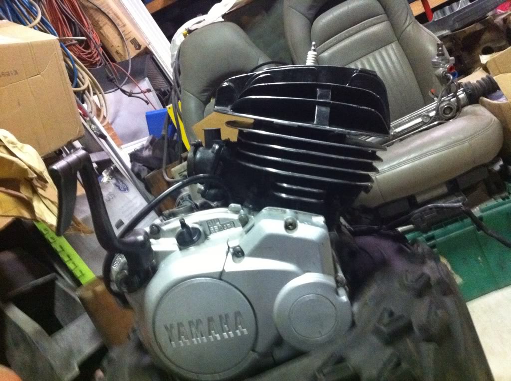

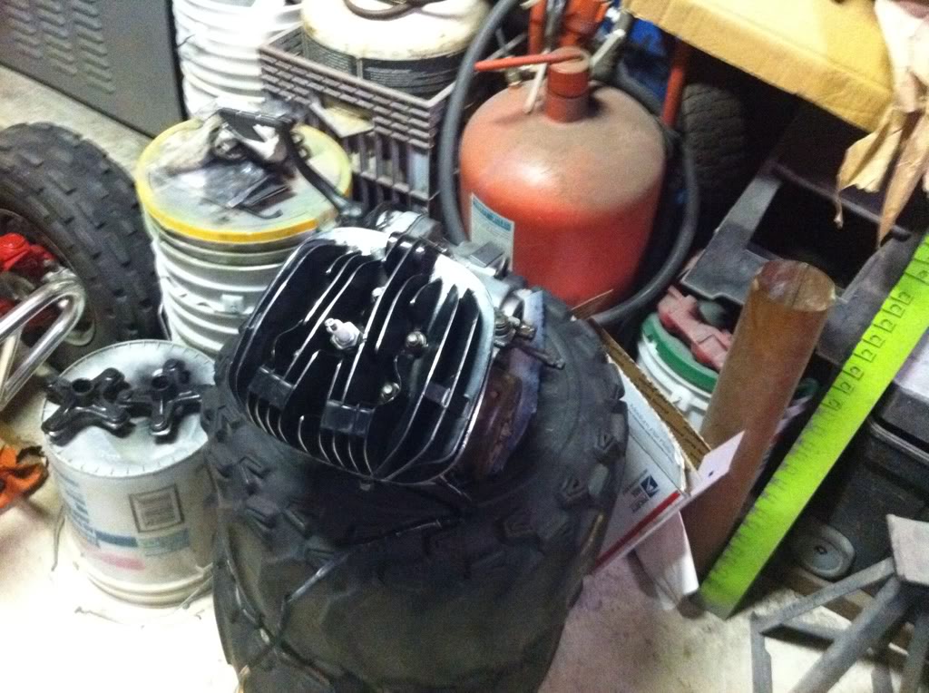

Hey guys, guess what I did

Running that engine without a leakdown test is just about as risky as you can get. You got some balls there bro, just hope it doesn't cost ya a rebuild!
is risky but not as risky as it gets. lol jb welding a brokin case at the seam then not leak testing is about as risky as it gets. i never hurd of a leak tester before this site, the good old fashon start it up and see if she shows signs of leaking. leak testers are the way to go, but damn if we dident have them im pretty sure some heads would expload up in here.
