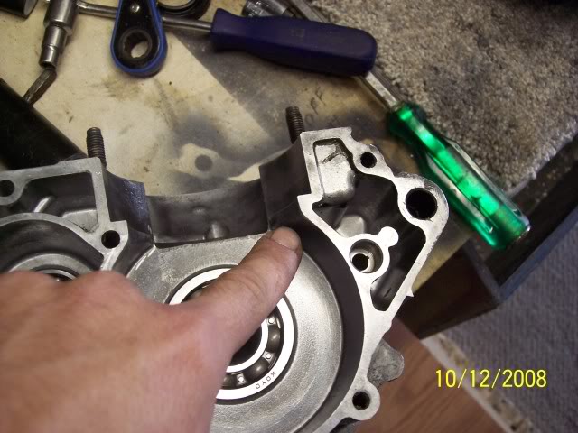

It was actually in freek'n'bat's two new rebuilds. You need to do some filing at the top of the cases and you can either take some metal out of the head, or use the provided spacer plate if you buy the full kit.
yea you will need to have you case trenched for the 4mm and you need head work dont .. for the 3mm it hits just a little bit so the case will need to be filed down some so it dont hit, and with the spacer they give you should send your cyli off to have the ports matched ..

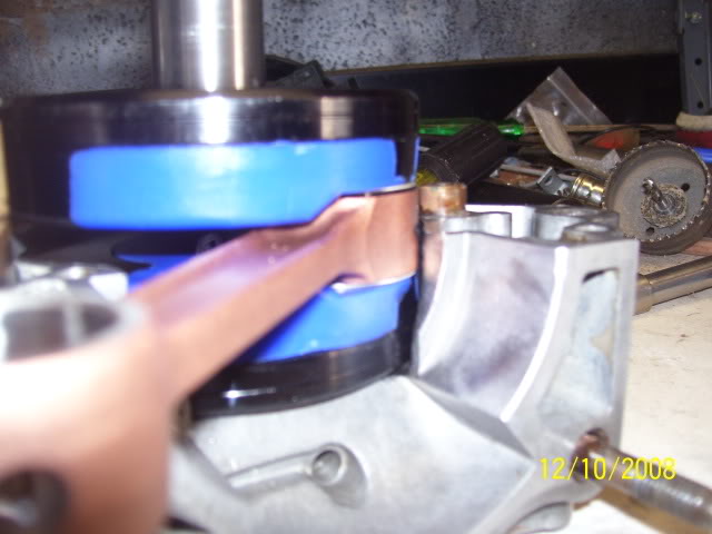

Yeah the 4 needs to be trenched but the 3 also needs a little filing around the top of the case's where the rod comes out and goes up into the piston. It hits when the rod is going in to the up position. It's no big deal though, you can do it yourself with a hand file in just a couple of minuets.

heres a pic of where it needs to be hand grinded down a bit
