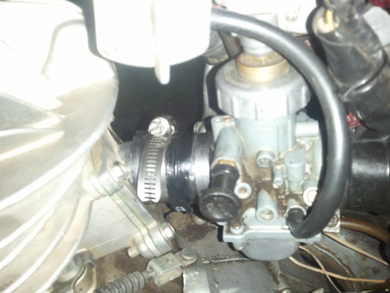

Hey guys my problem is I can't seem to get the carb to fit well. I'm just wondering if I used the stock boot from the jug to carb if it will fix it or will it fit bad. Also noticed that the plate that bolts to the reeds and back of the head says boyseen reeds and is the tip where the boot connects to has kinda of a turned down tip is this the same as stock.
anyway any help or sugestions would be great.
Tried to take pics so u can see my problem got the quad like this.
that is not a stock boot but it looks like a stock carb. you will probably just need to find ya a stock boot. i got some layin around i would send ya for 10 bux
that looks to be a boysen rad valve ?
oooh my favorites....not, LOL
but i see an intake and a seperate reed cage ???
if a rad valve, the reed cage and intake are all one piece,
either way... that rubber boot looks toast !
to use it:
i'd measure th OD. of the intake and carb, then order a cooresponding ID fitting from here, either a straight fitting if they are the same size, or a reducer fitting if they are different OD's...........
Intercooler Pipe Fabrication - Silicone Intake Systems Auto Parts
/\ get the clamps from there too
or find someone on here with a stock cage and boot
then use that rad valve (?) for the paperweight it was meant to be, LOL
or ultimately ....get a set v-force 3's
Ok and if you look close to the plate that holds in the reeds it says boyseen is that connected to the reeds? Like a rad valve? I think they used a radiator hose as a boot.
I was just wondering is it bad to use the radiator hose as a boot?
look at the results in your first pics I:I
the better option is a "fernco" fitting from a plumbing/home store
best option is the silicon intakes boot i posted the link to above
