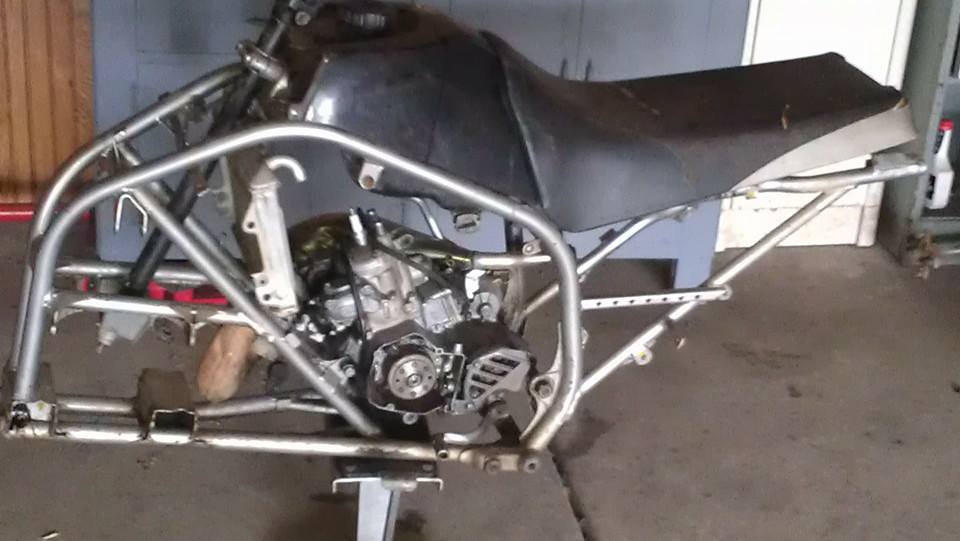

Well, no pics as of yet but the cr125 motor is almost a drop in. The cr radiator will fit pretty good. It's the exhaust that will be a headache. I do have some pics on my phone. I will try and load them to photobucket and post them.
Awsome! Looks like its gonna be a fun project! Is that another mounting hole on the bottom of the cases? If it is, I reccomend that you fabricate/ weld some mounting brackets on the
Frame, it would definatly help reduce vibation considering a cr125 engine is not counterbalanced.
I had planned to do that. Won't be able to make the head stay work. I wish I could though
