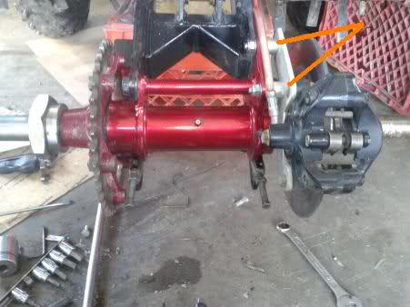

as some of you may have seen, my RAD carrier has devleoped some play in it between the mounting ears and carrier tube, and has to come out to see if i can have it welded
so i threw new bearings in a stock carrier to use temporarily.

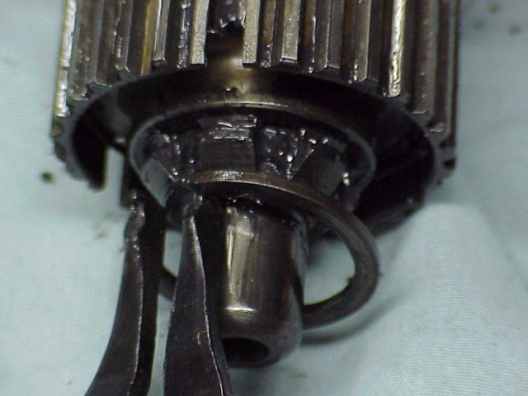

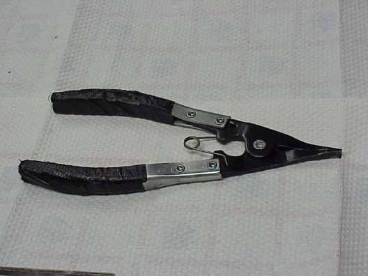

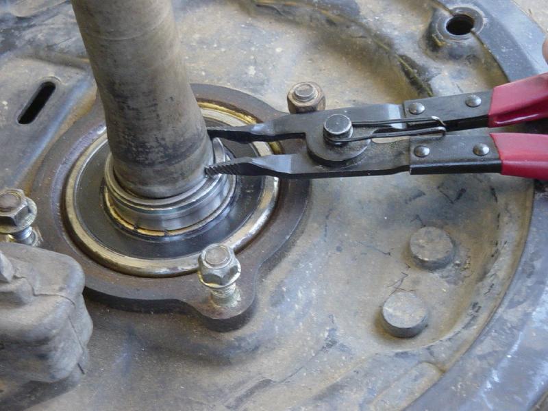

I have a lot of industrial experience with every sort of "C" type snap ring imaginable.
Is it this type here:
images
If so, you need this type of plier here:

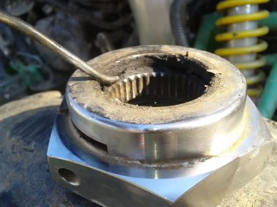

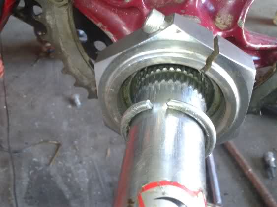

just a little heads up of what i was dealing with for anyone else who may encounter similar problems with the g-force axle..............
this first pic is of the 3 piece locknut, and where the grease/dirt had built up, preventing it from adjusting enuf to expose the c-clip for removal, this side of the nut is not visible when installed, it rests tight against the sprocket hub...........
this pic shows the groove in the axle, now exposed enuf to remove/install the c-clip.....
and i finally determined that it is the g-force axle, not the rad carrier (i added both at the same time) that requires spacers for my gsxr brake kit, seems the axle holds the disc out further than a stock axle ???
guess i'll have to add that to the info i require before building any more brake systems ???..........
Man that is strange you had issues like this. I used this axle since day 1 and it was in a stock carrier with no issues. Our blaster was an 06, not sure if that matters. As for the ring I have a set of spreader pliers I bought 20 yrs ago off the snap on truck and they also work great but I also believe I just pried it out with a big flat screwdriver once also during our 2012 rebuild.
