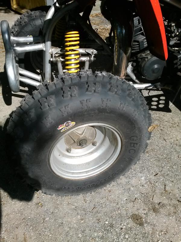

Ok the castle nut was a little tight but the front brakes were dragging also. Thanks for the info guys. Here are some pics of the new tires. I also threw in a pick of my clutch cover with a messed up gasket will this hurt anything? Also do I have the tread going the correct way. There is no direction arrows on the tire.
