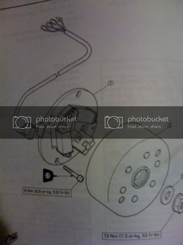

i had just put the whole stator assembly in does anyone have a picture so i can see if mine is in the right position, as my bike didnt have it when i got it thanks
i had just put in the stator assembly, so is there a pic of one that is in its propper position as the manual i have doesnt show a proper picture of it. thanks
Here is a pic from my manual the as the left of the pic being the front of the motor.
that is the same pic as the one in my book but i guess i was more or less looking for a pic of one on a bike so i could see the positioning as i can see how it is possible to put it on backwards, also is it possible that a gear inside could have messed up either on the transmission or in the area where the kick starter is that could have caused it thanks
ok so after some more research today found out that the 03 on up blasters with the 5 wire design changed the location of the woodruff key so that the timeing is different than an 02 on down models makeing it important to make sure that you have the right stator plate on it which now means haveing to buy a new assembly on monday.
