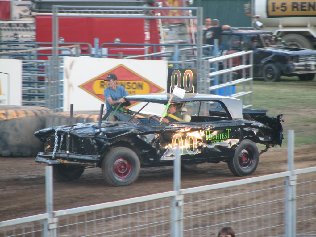

Most us Derby's (Notice my Screen name) require you to use either a Jeep can or a boat tank located directly behind the drivers seat. Your fuel line runs through the car and passes through the fire wall to the carb. This keeps it from Getting damaged. I ran several derby's before giving it up about 5 years ago. Several top 3's and I made the main event in every derby I ever ran out here in Northern CA.

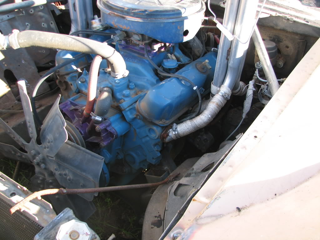

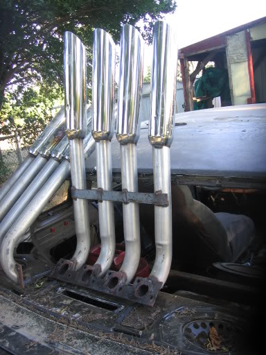

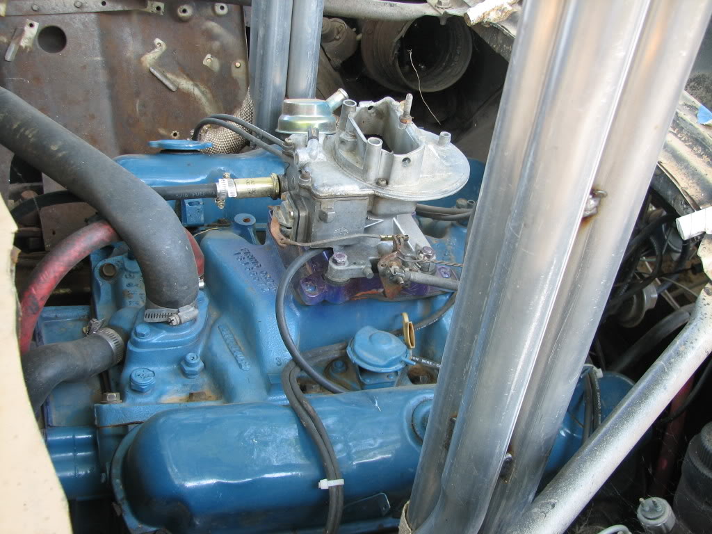

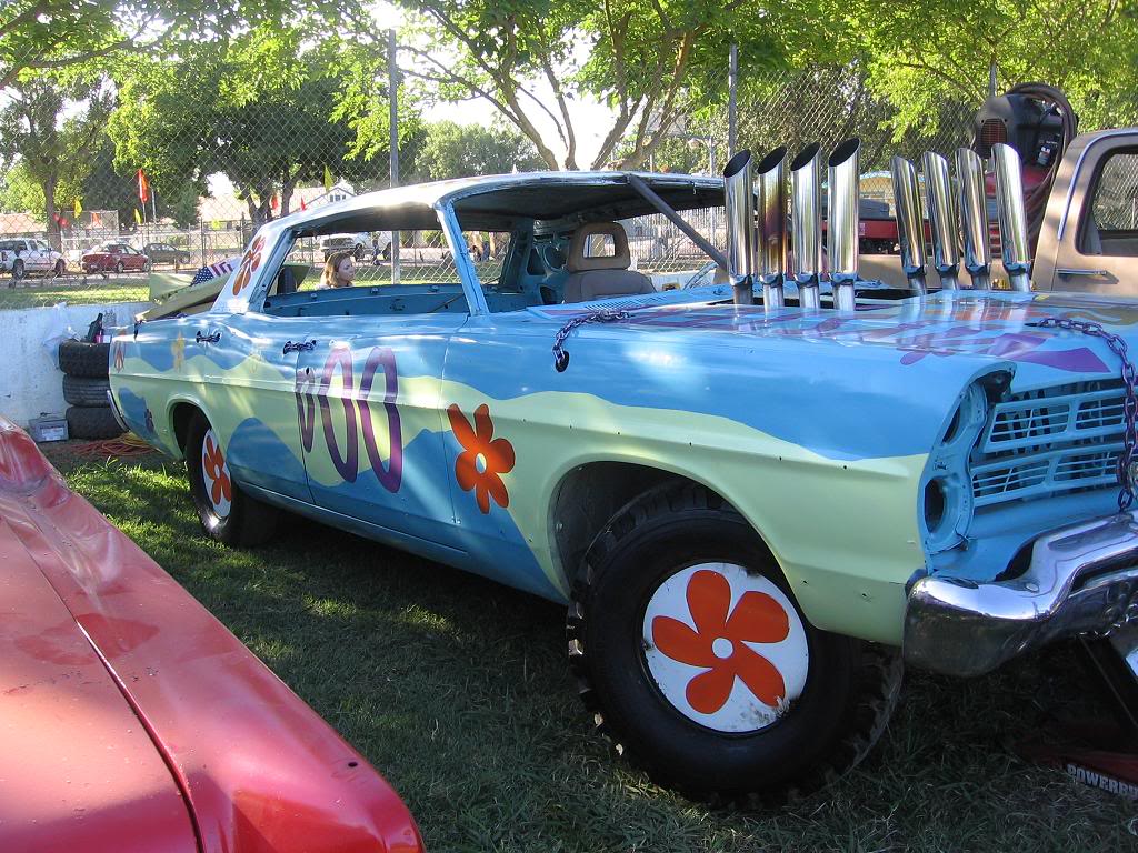

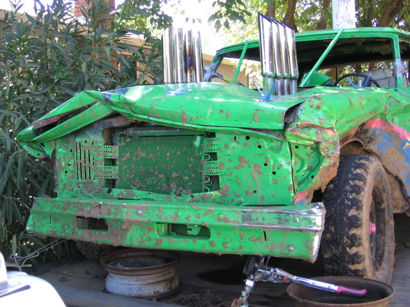

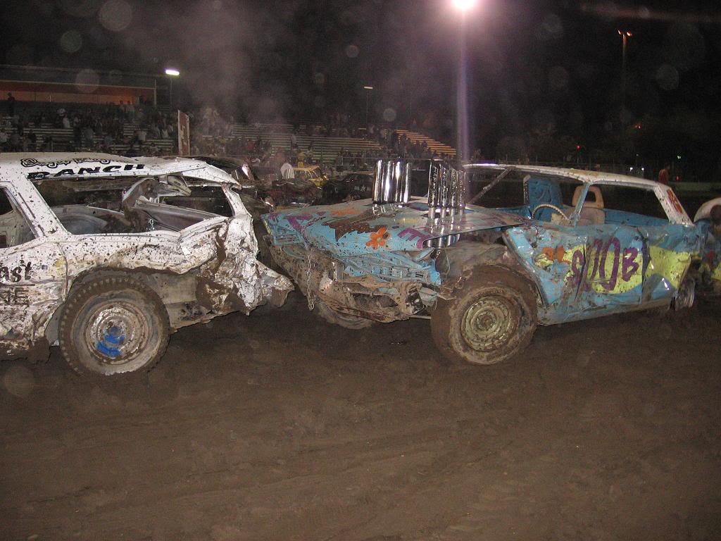

Also, make yourself some zoomies to keep your exahust from getting messed up. You can see my 4x4 zoomies in the pic above and here are some others I made
here are a few of my cars

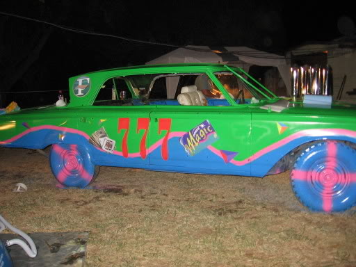

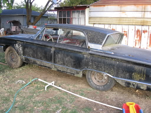

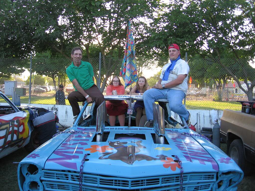

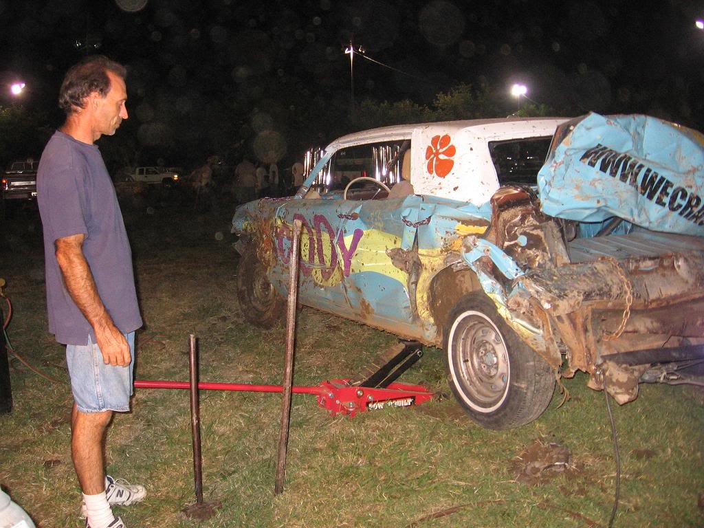

1962 Mercury Monteray. ran 3 derbies with it.

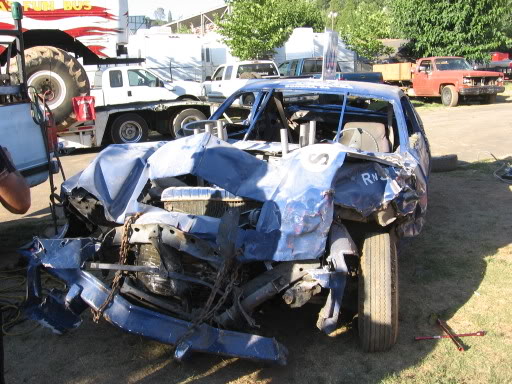

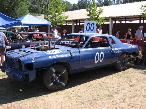

1977 Cordoba (Factory double rear frame rails)
After my heat (Qualified 1st out of it). Fixed the car and took 3rd in the main. Found myself as an outsider against a uncle and nephew.

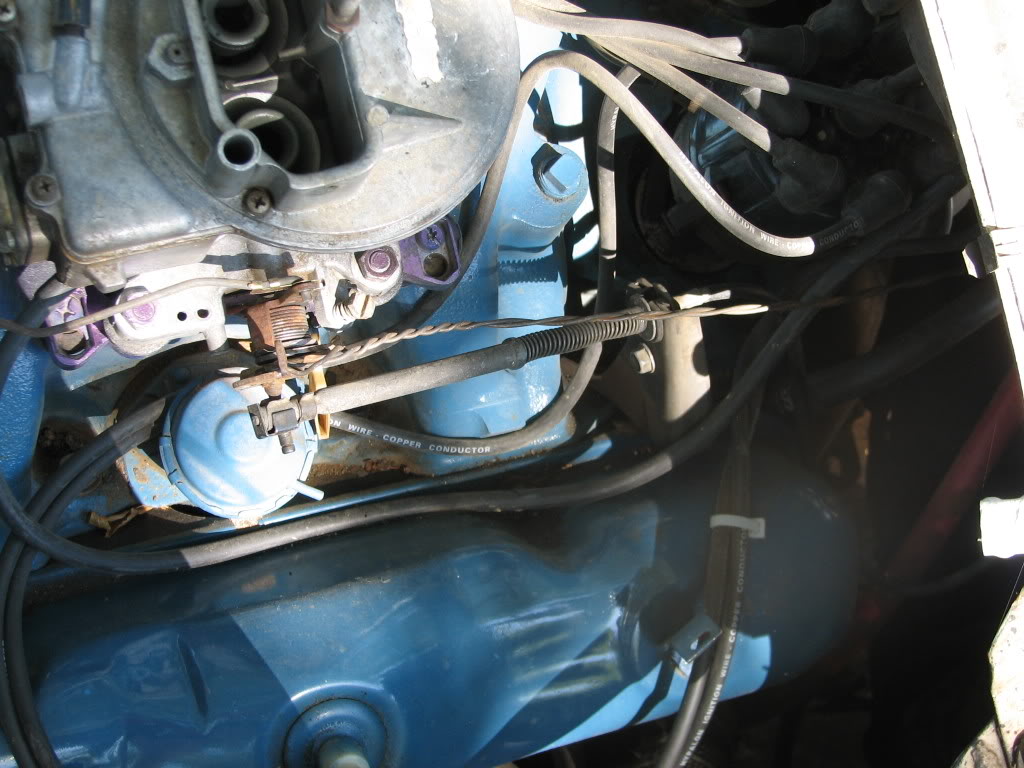

This picture shows the hand throttle, always a good idea in case your gas pedal cable brakes.

1967 Galaxie 500 (POS Car)

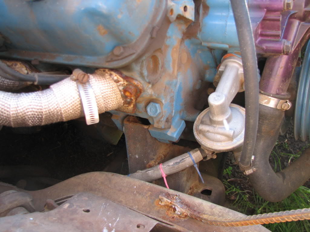

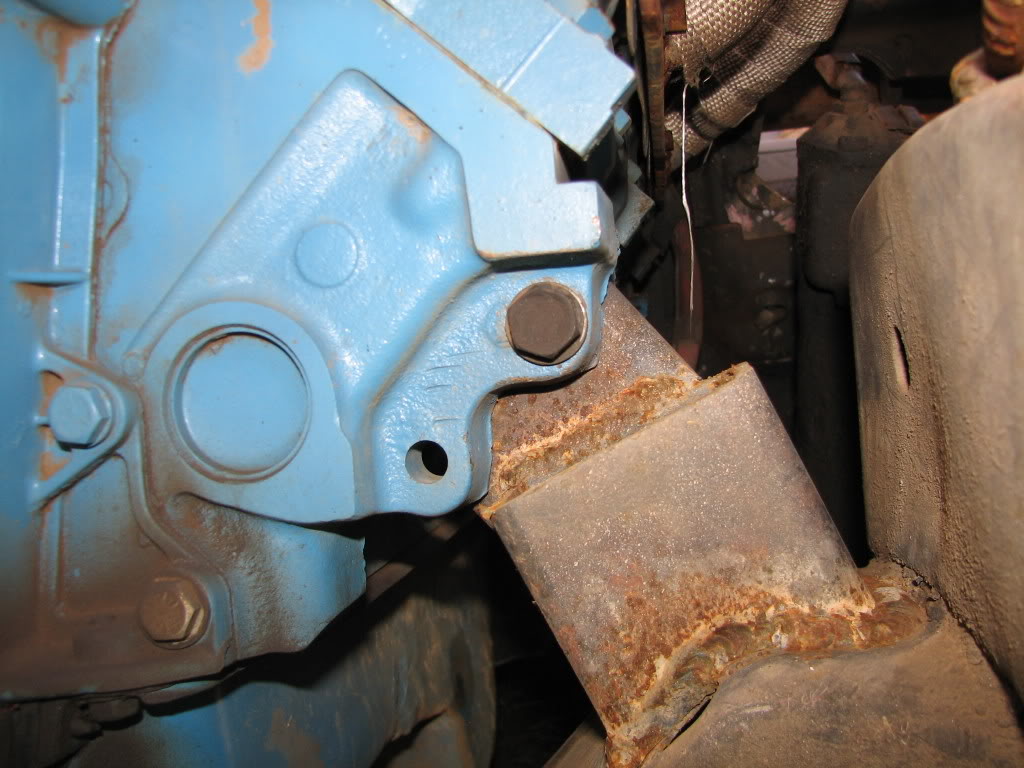

And always ALWAYS build your own motor mounts, the stock mounts break way to easy!

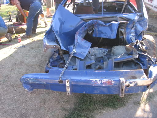

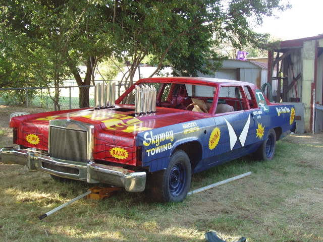

1 last car, THE SPIDERMAN LINCOLN

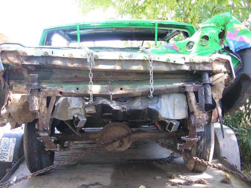

I ran several other cars as well, if you have any questions shoot me a PM, I still help some friends build cars every year. This pic was how the car entered the Best of show before the Derby. The fenders were cat as soon as that was over to get it ready fro the heat.
