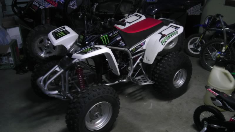

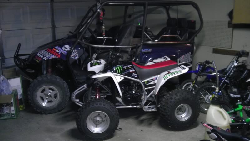

Here is the craigslist picture from when we first picked it up...
Here is what it looked like after stripping the old graphics off...

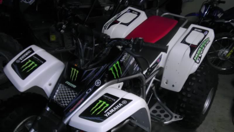

Now what it looks like after I put the new graphics kit on it last night, the new seat cover is coming from my good friends at Quadtech it will have silver green and black colors to go with the look I'm shooting for.
I made my own alum grill on the front hood with some alum mesh I had sitting in my garage.
