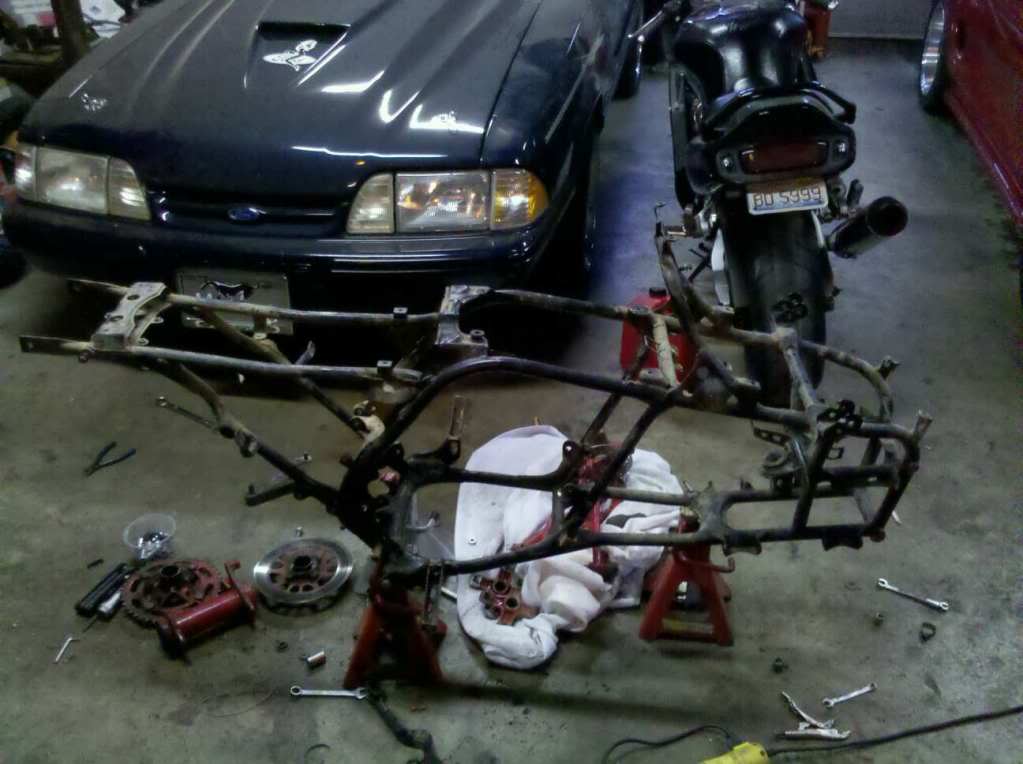

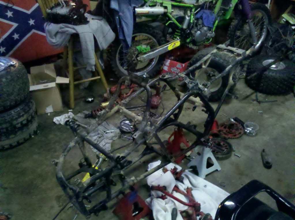

I had the frame media blasted and found it had been wrecked and cracked so i took into the shop and welded it all up and added some material to strengthen the area.
After the repairs were done i had it powdercoated.I with a pearl white basecoat and then 4 coats of jolli pop metallic red it looks awesome.These pics were taken with my droid so they do no justice for how it looks in person.
Here you guys go my official budget banshee build.

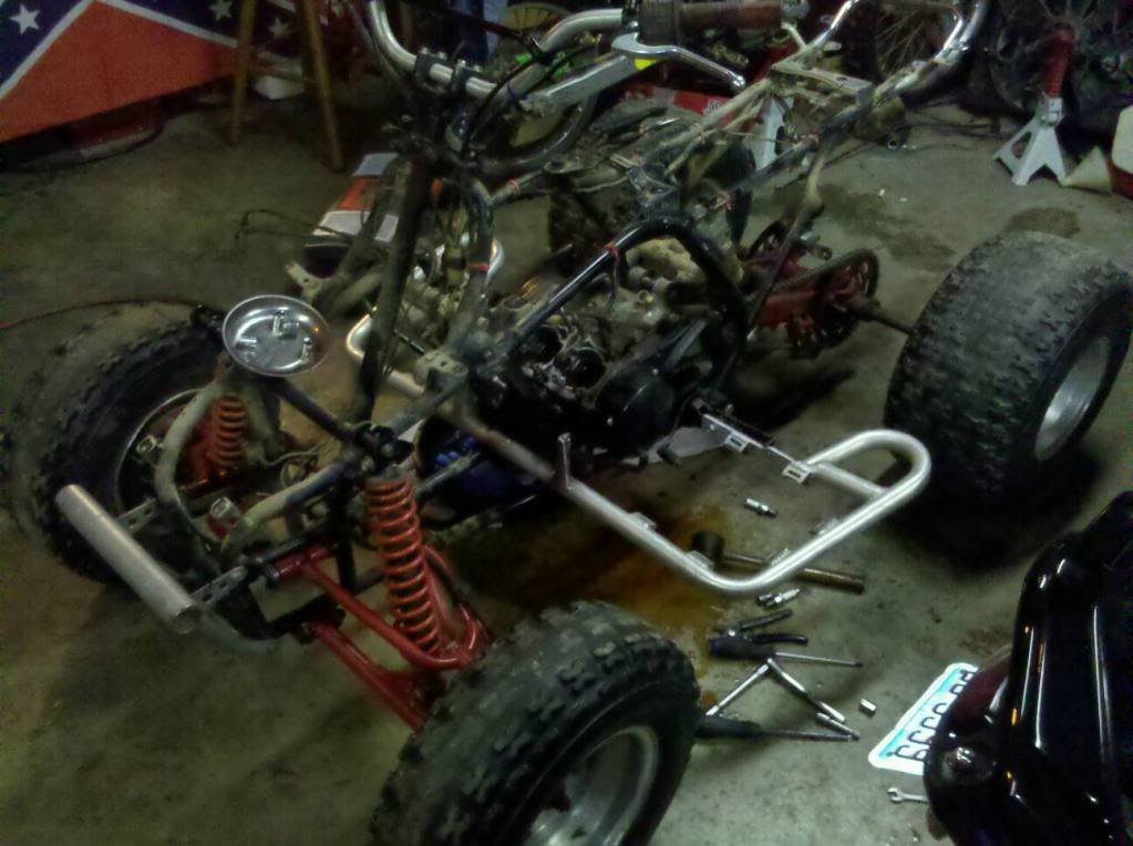

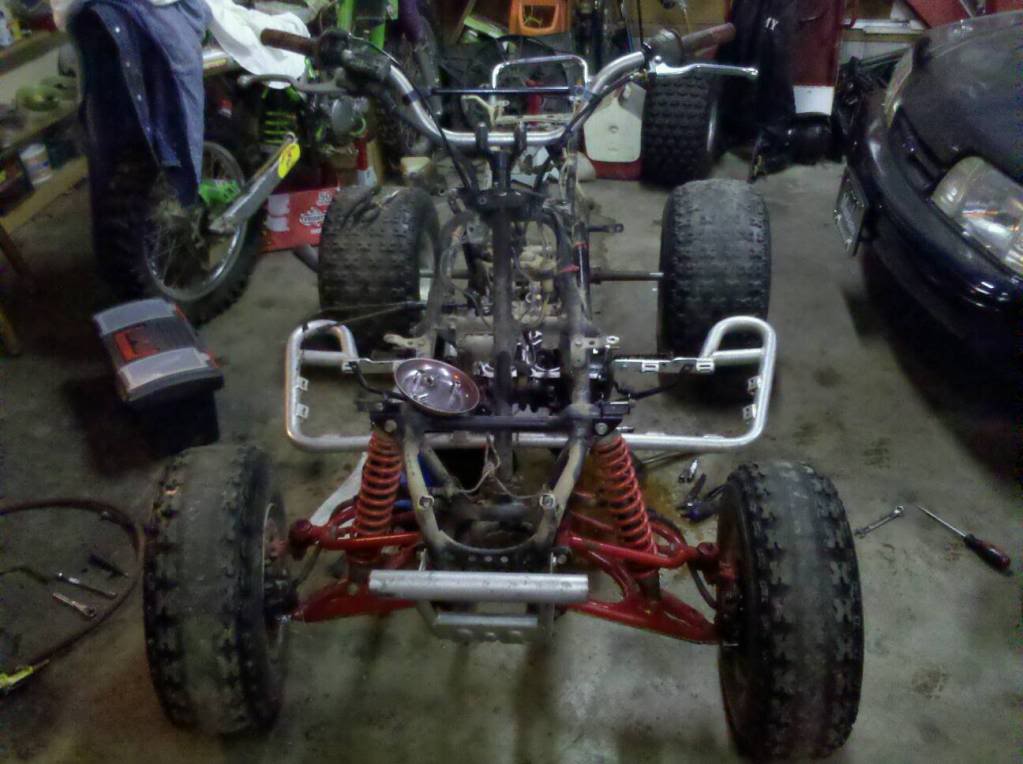

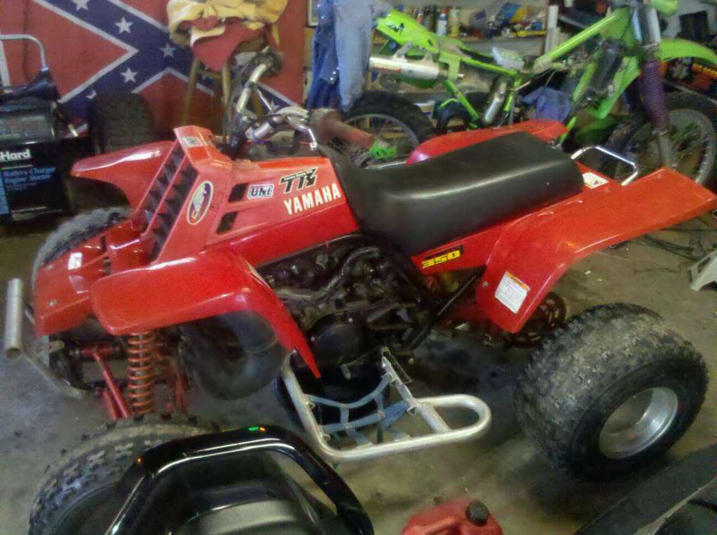

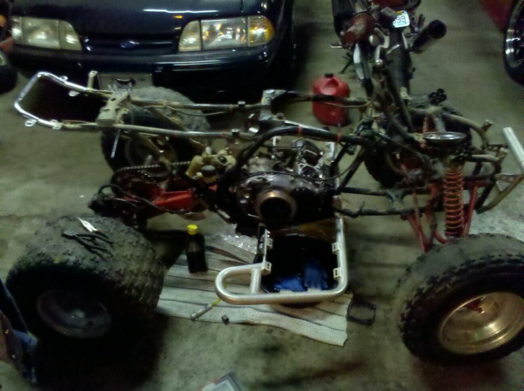

Heres how she started when i brought her home.

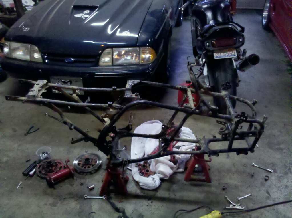

And heres the frame stripped and ready for media blasting
