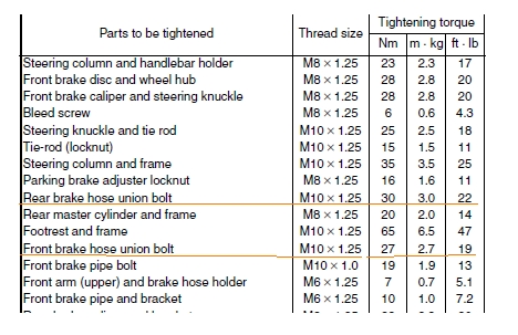

Hey guys, working on swapping some hydro front brakes to my buddies blaster for him. We are missing a banjo bolt for the master cylinder line.
What size bolt do they use? Are the bolts from the calipers the same size as the master? Where can I find one to buy? Any other Yamaha models interchange?
Thanks.
Thanks guys. I thought they were the same on the sport quads, but wasn't sure. Might check the local AutoZone.
I used a TRX250R brake lines with mine because the TRX lines were longer and was long enough for my +3 arms. The banjo ends and bolts were interchangeable between the Honda and Yamaha parts.
I'm fairly certain that the kawasaki, yamaha, and honda use the coarser threaded M10 x 1.25 banjo's.
Suzuki used the finer ones, M10 x 1.0. They are some real odd ball stuff....
aha, the answer was right under our noses............
found in the general support section on page 11 of the 03-06 manual supplement
http://www.blasterforum.com/general-support-17/downloadable-yamaha-blaster-manual-17325/
