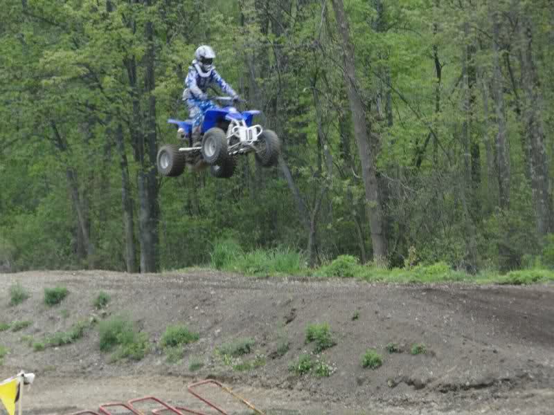

This is Quadrider10 in flight, he uses stud extensions.
