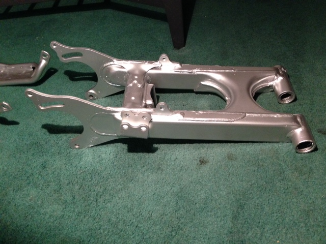

Also I stripped everything down to the frame and am slowly working on repainting it all. The new silver color on the swing arm and chain guard looks beautiful!

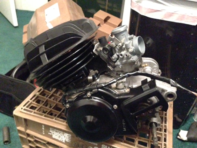

Here it is! Waiting on a new kickstart spring, found out the hook part was broken off last minute :( And while I'm waiting I ordered the oil pump block off plate since the pump has never been used anyway while I've owned it.
So oil pump plate, new kick start spring, cover and fill it with oil after it's installed.
Still working on the frame and going to repaint tomorrow. Here is the swingarm all doctored up. Got new bearings and seals for that too. There was almost nothing left in there. Took some convincing with sockets and a huge hammer to get them out...

congrats for the full engine teardown/assembly
but we get no closeup pics of the ebay cylinder and parts ?
no piston to cylinder clearences taken ?
leakdown tested ?
Reactions: Larry's Shee
X-2 on what Awk said. Hopefully the ports were champhered properly. If no pics :mad: at least give us a good description of how it looked. Any excess casting boogers? Fit and finish?
Please be sure to leakdown before starting it ;)

I didn't get too technical on the new head. Just comparing the weight by hand they felt identical. I noticed no differences in design or quality comparing the OEM to the new one. The piston slides up and down inside perfectly fine. The gap between the piston and head is way better than my OEM one that was probably slapping back and forth off both sides.
I am confident the head will be fine, and I hope it is so I can do a good review on it so you guys can start buying them instead of getting the cylinders honed
Not trying to be difficult, but have you actually measured anything with a measuring device.
There is no way of checking clearances by sliding the piston up and down in the bore.
No one, and I mean no one, can compare quality by using hands as scales, tolerances are measured with precision instruments.
