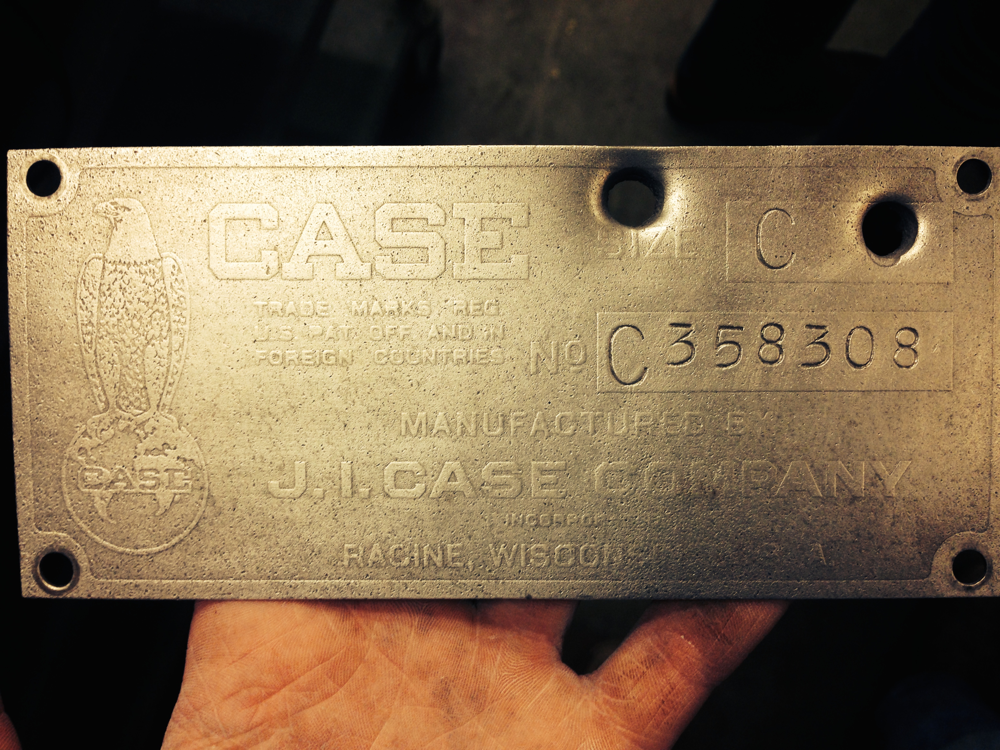

what caliber do you suspect made the extra holes ? :)
img_2605-jpg.22530

Thanks guys! I try not to think about who or what put the holes there but I'd sure like to give them a piece of my mind!
