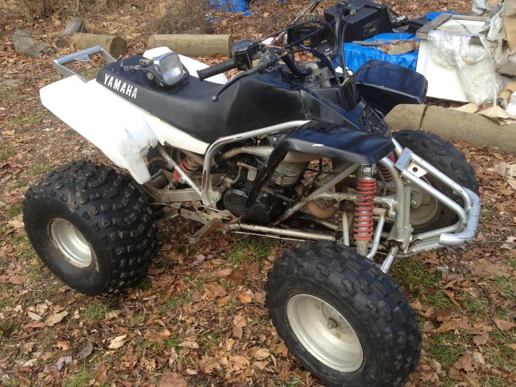

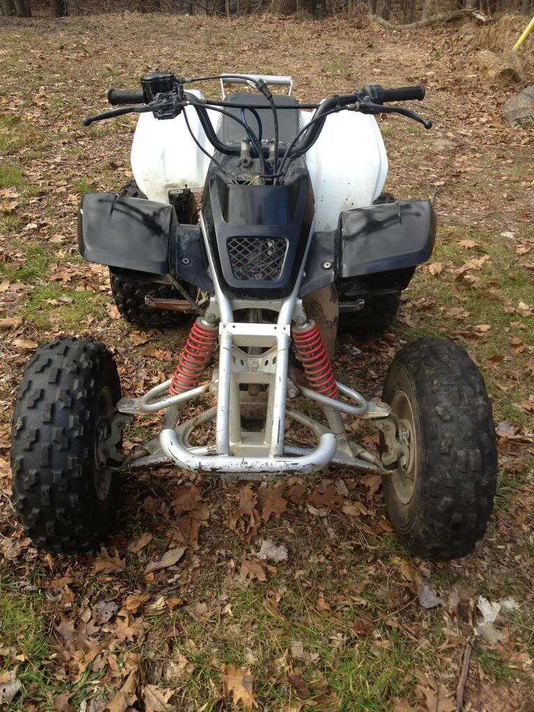

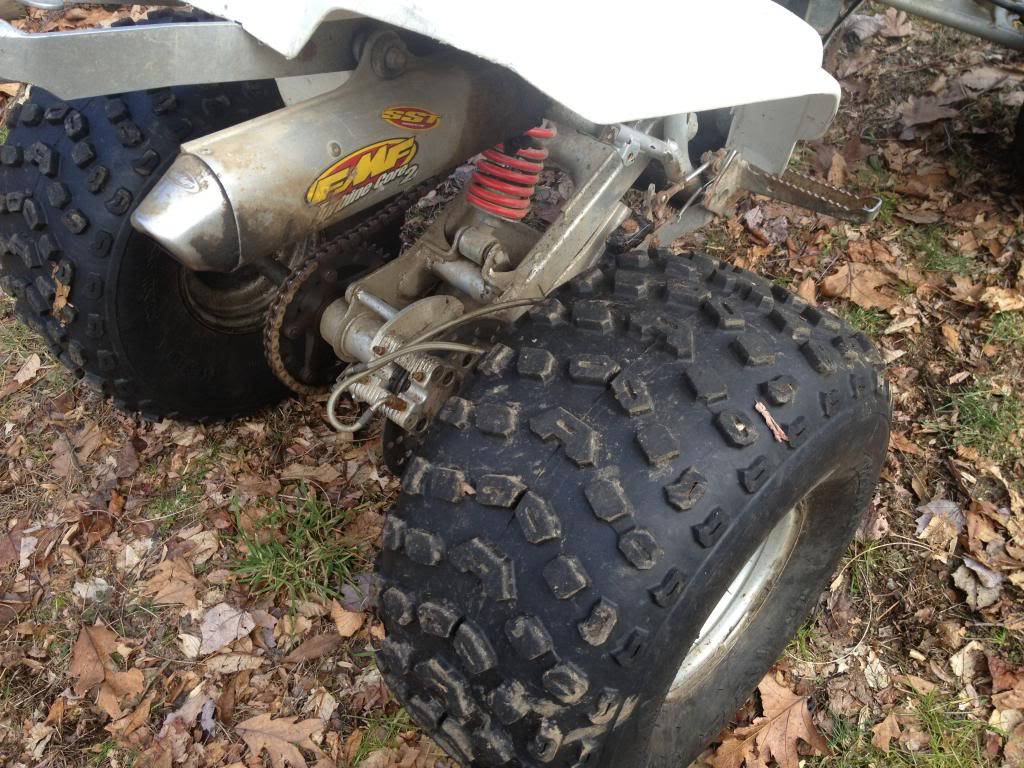

Thanks for the help guys really appreciate it.. I'm trying to explain that to my family haha..I got around $120 left over since I talked him down.. i may just buy a whole new carb and me and my dad will install it.. My dads good with cars and quads.Here's some pictures:

You did alright for 650 I:I. You don't need a new carb, you need a CLEAN carbI:I
And you don't need a stinking harley guy touching itX(8-|!! Save your dough, these things are about as complicated as a rock. On this site you will find download manual, repair and mainenance tips, and just about anything you want or need to know about your blastee. The search function works extremely well on this site I:I

What kind of rear caliper is on that thing?
I'm actually not sure, I'll take a look tomorrow.
And yeah I got the refrence.. I know what to do now. My uncle told me to bleed the breaks and add fluid.. If those are the two same things, I'm sorry, I don't know much about these. I'm going to look at some youtube videos tonight and troubleshoot. It was a bit weird when I test rode it, haven't used clutch in years, had no breaks going down a hill unsure how to stop it..
