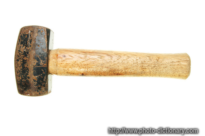

Unfortunately, even as facetious as some of the ideas are (I like the picture of the BFH and the thought of C4 down a spark plug hole) there's some truth in them both. The first step is to take off the cylinder head and see what you're dealing with. A good forged piston will scour aluminum to the cylinder wall instead of disintegrating...
