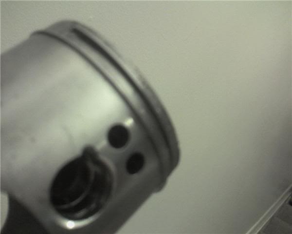

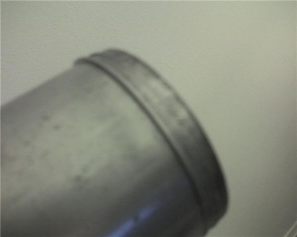

I had this top end in for maybe two weeks. Did I do something wrong or is there something wrong with my cylinder ? The top ring fuzed in with the piston ? Maybe I put the ring in wrong ? Because the bottom ring is good.

Yes I still have the stock oil inj but the bike was smoking so I didn't think that was the problem. Idk about the tune ? The stock piston cracked it didn't look like this one.
Hows your spark plug? does it have little balls on it? How about the piston top, is it pitted? Thinking you might be running lean or had lean conditions while running, Maybe even preignition or pinging as some may say.
thats alot of piston wear for that much time what was the clearance piston to cyl wall almost looks to tight aka hot sieze. not broke in enough
My spark plug looked fine. Every where else on the piston looked fine. I did not notice any other damage. Do you think this could have been caused because I didn't break in the motor correctly ?
