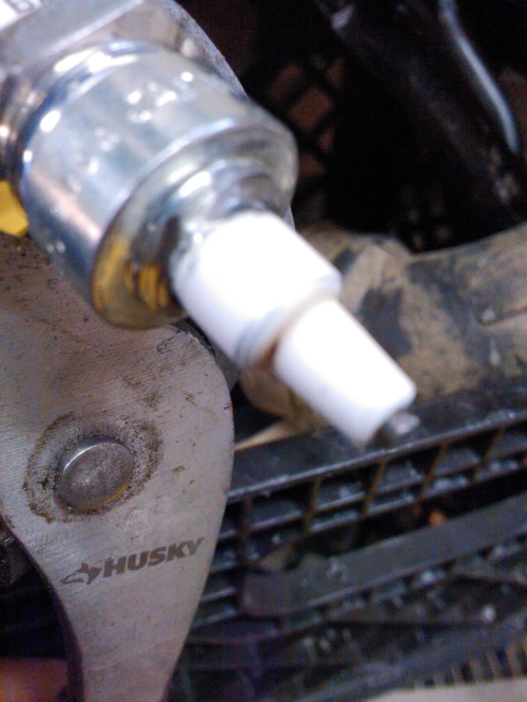

Motor is air tight. Did a run 1st-6th gear last night. Held it for as long as i could (probably 5 or 6 sec.) Was around 40 degrees. Should this plug have more color to it. the shade of the color looks ok to me sense it's going to start getting warmer. Just seems like other plugs I've seen show more color.
yeah, the blur is kinda hampering a clear veiw of it
if what i think i see is the smoke ring, it does appear to be spot on.
i like them a little darker myself, for safety.
we're not racing anyone tomorrow
It is the right color. It's the size of the smoke ring i was concerned with. Being that it will be warming up I'm going to leave the 158 in and do a 160 or 162 in the winter.
