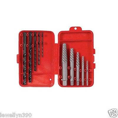

i have also used these broken bolt extractors, but you'll need to remove the engine from the frame to get a drill on it, or use a right angle drill
http://www.ebay.com/itm/CRAFTSMAN-1...313?pt=LH_DefaultDomain_0&hash=item4ac33209b9
or these:
http://www.ebay.com/itm/BRAND-NEW-8...736?pt=LH_DefaultDomain_0&hash=item3a89c0b7d8
These are the easy out style bolt extractors that I prefer to use. Both work good but I have always had good luck with this style of extractor. Drill it out, tap it in gently to seat it and turn it as you would.
http://www.ebay.com/itm/Blackhawk-b...054?pt=LH_DefaultDomain_0&hash=item3f31a1485e
Edit: I just did a general search for the shank style. There may be better priced ones on ebay out there or better brands.
