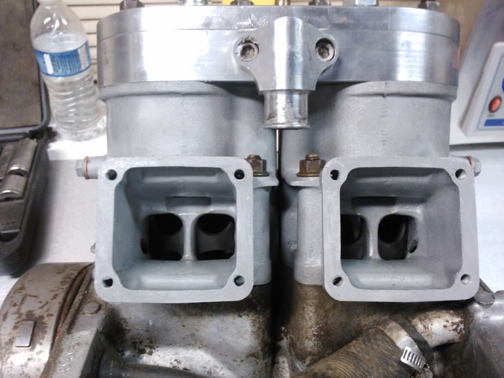

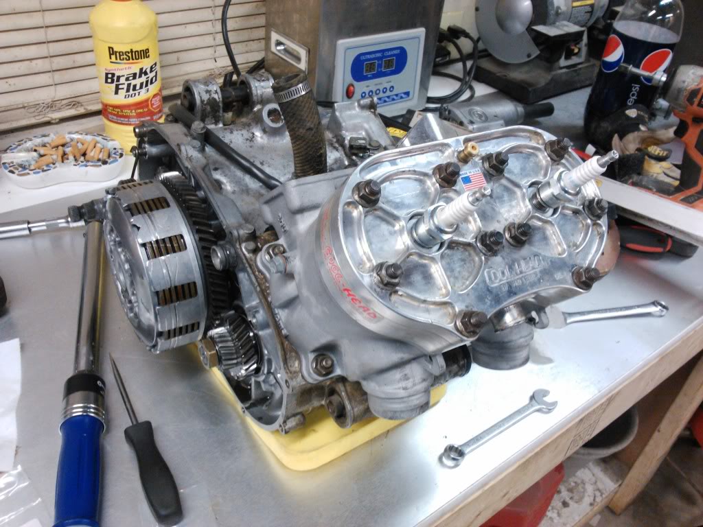

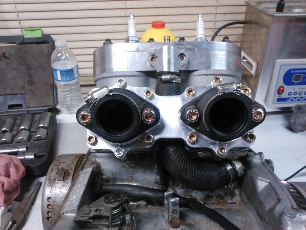

Put in the new studs and got the cool head on.

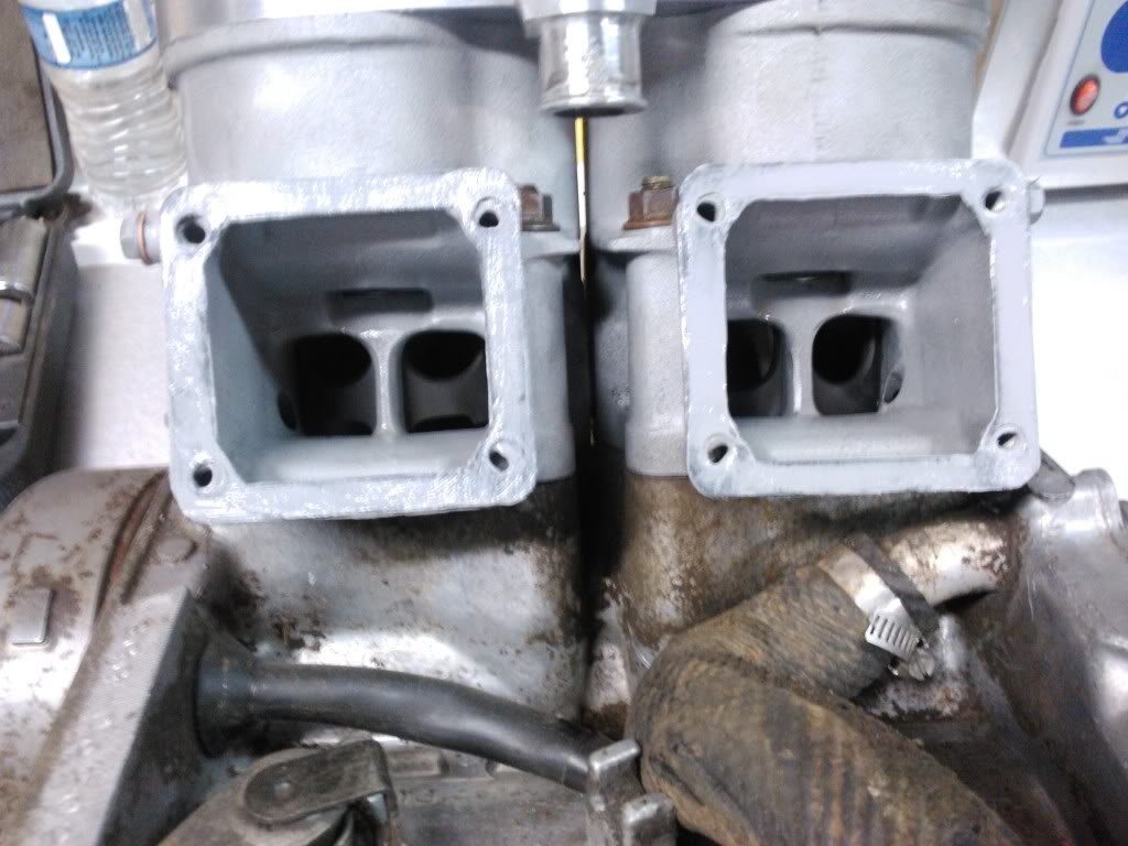

Just some more pictures of the Ken Occonor ported cylinders!

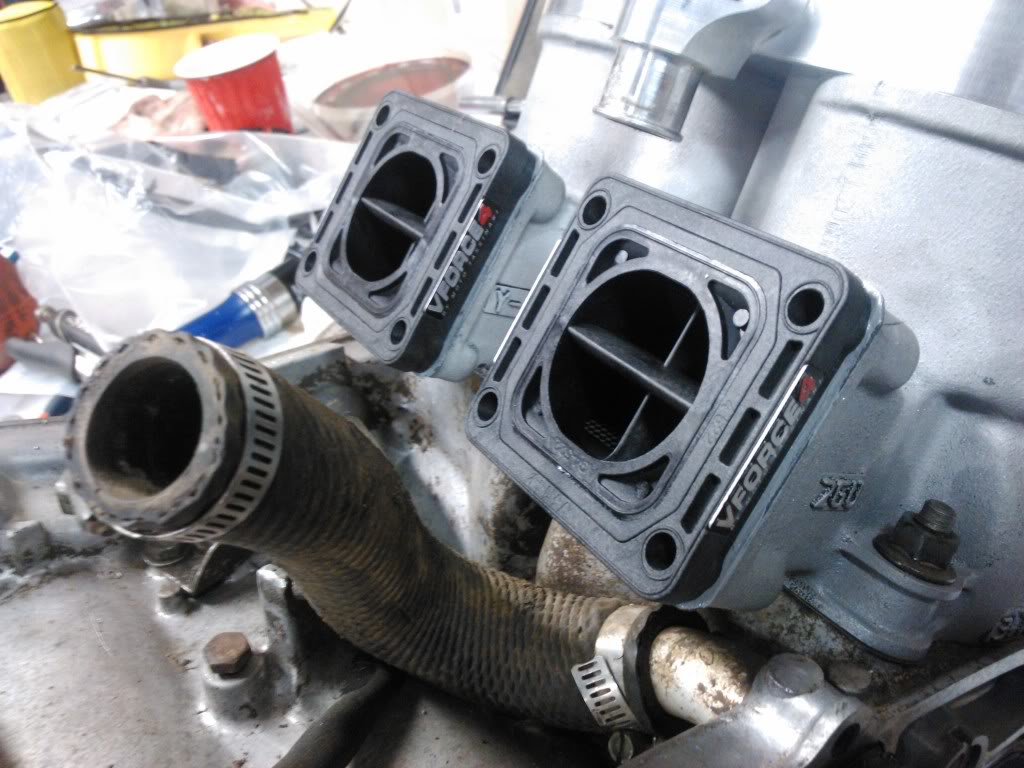

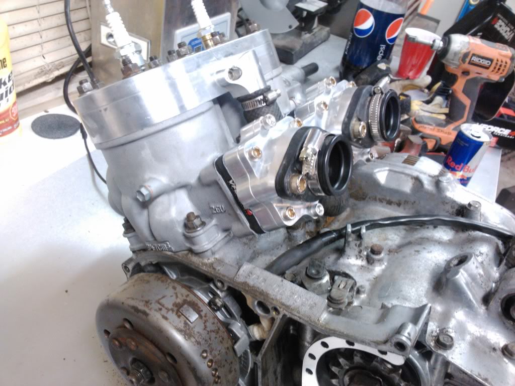

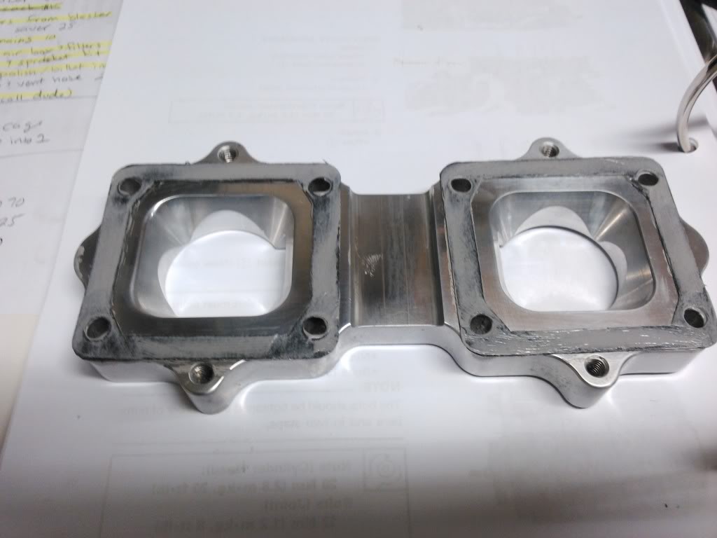

So next was the intake. Used a thin layer od yamabond on every sealing surface

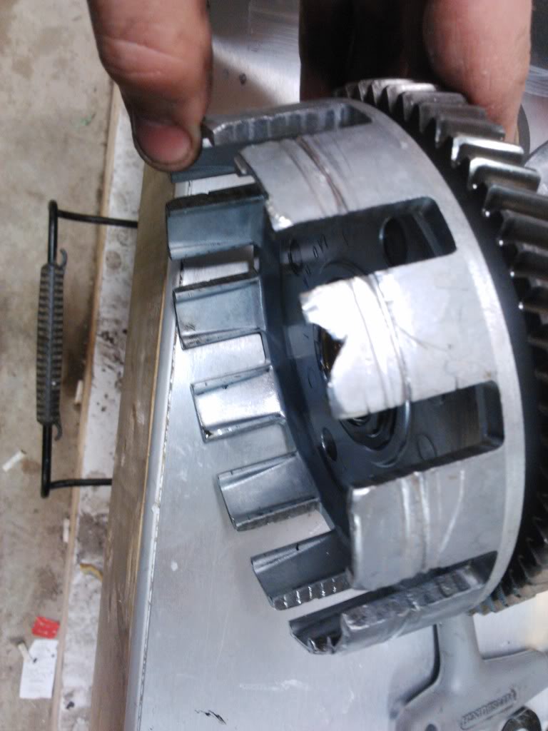

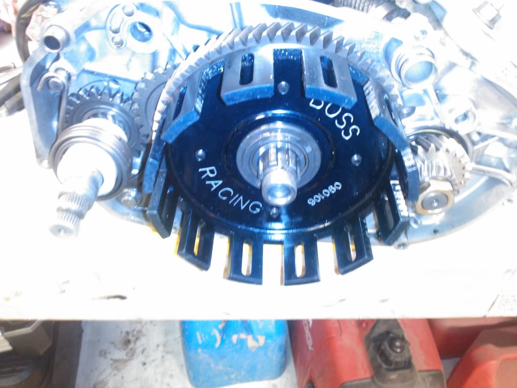

Now on to the part that completely whipped my azz. THE CLUTCH!! Should have been very simple. I bought a boss clutch basket because the stock basket was trashed. I also bought a tusk hd clutch kit. The clutch in this motor was so f'd up! So after I pry all the old plates out of the basket I find that the nut that holds the clutch boss in is loose. That was the first sign.

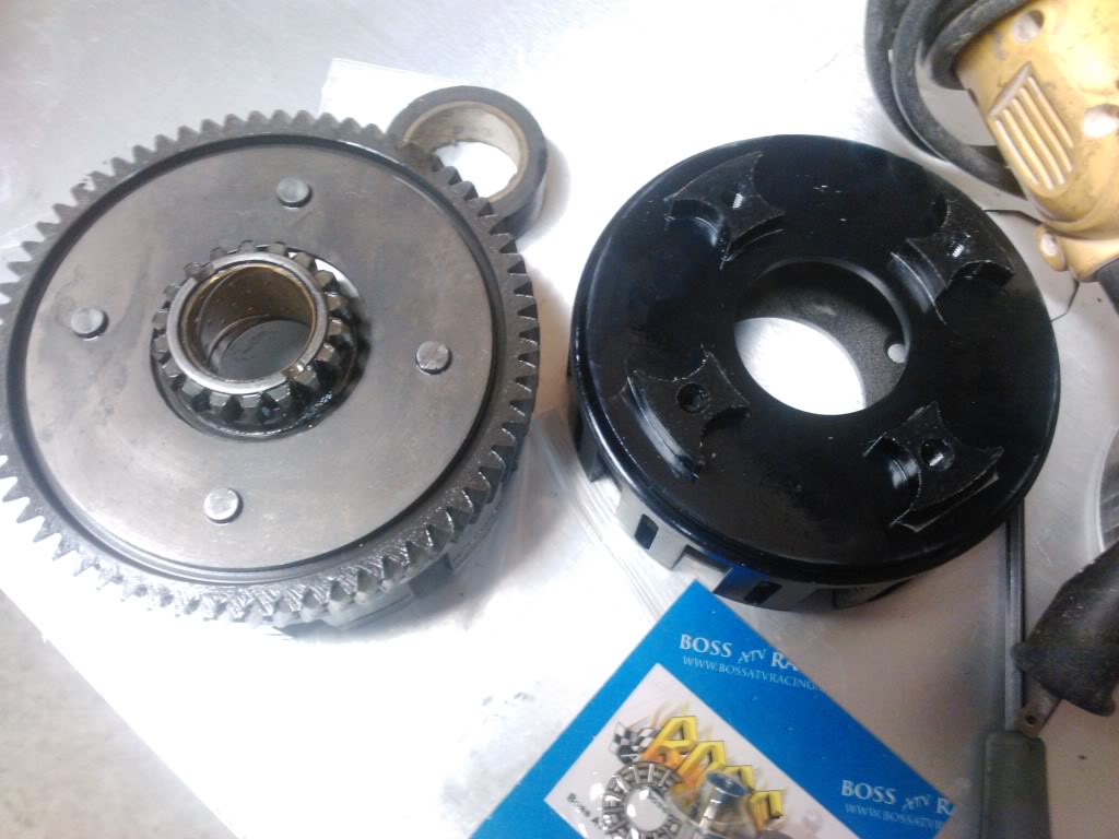

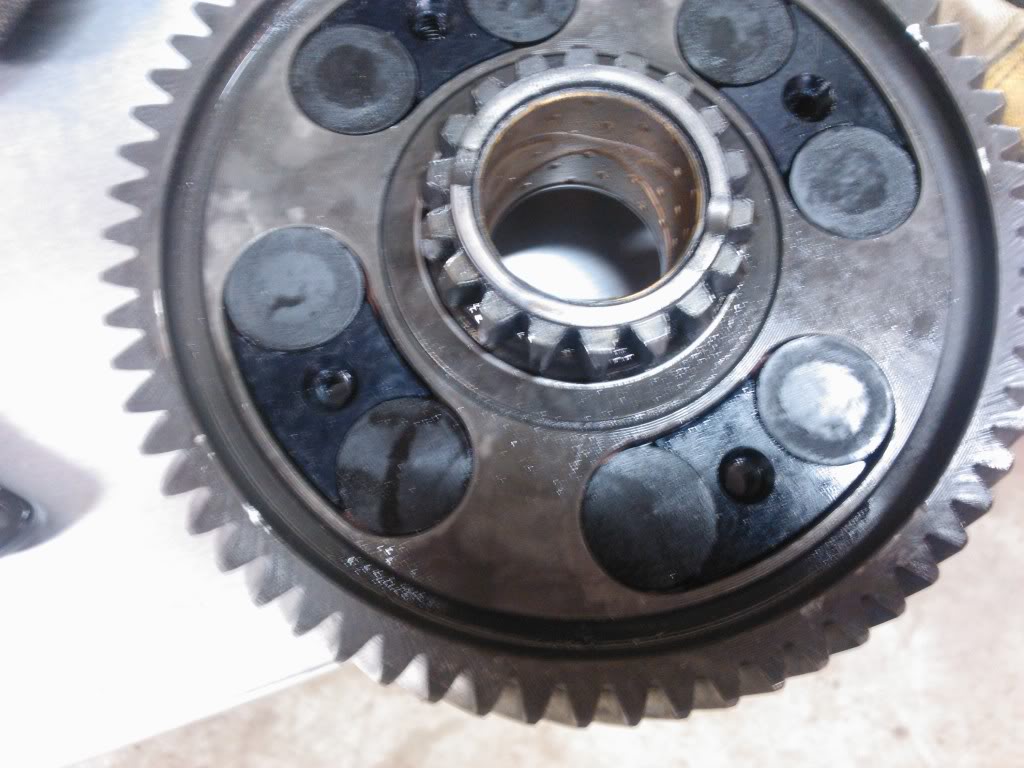

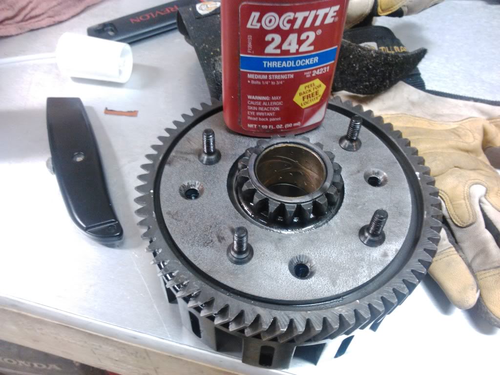

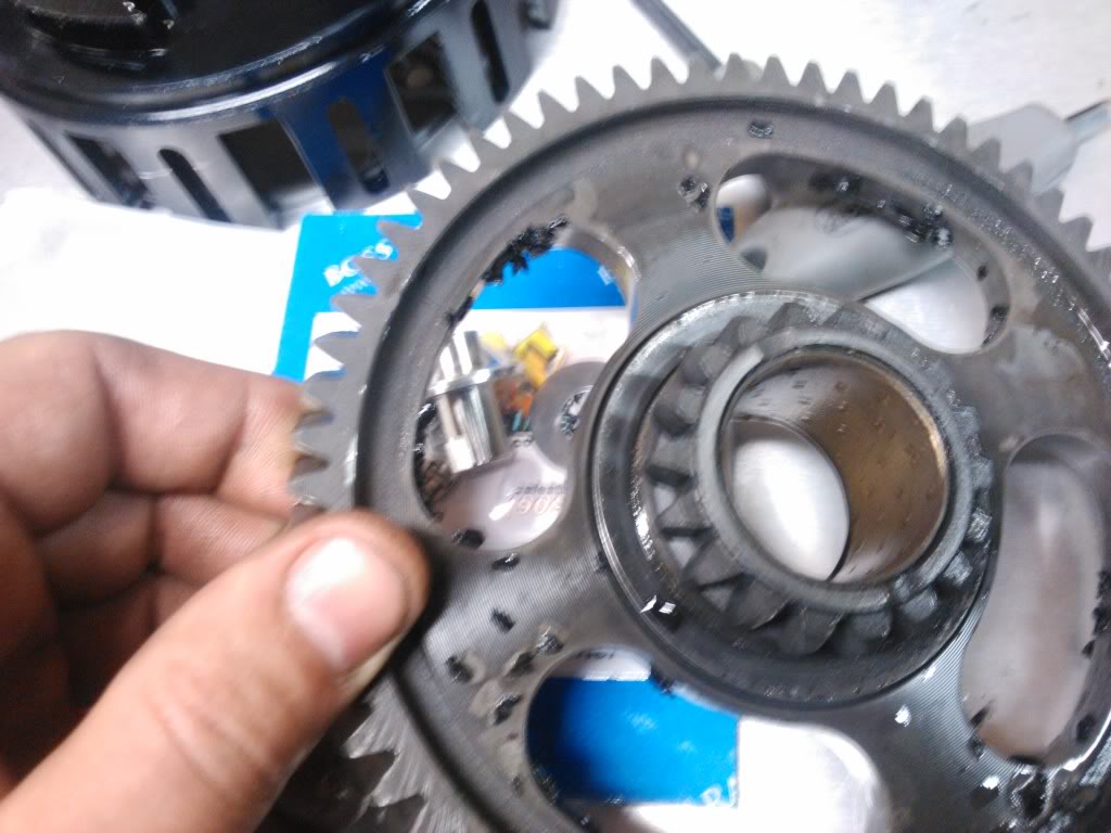

So now it's time to switch the gear from the stock basket to the boss. This went very smooth.
Not sure if I was supposed to put this on the new basket, but I figured it can't hurt anything. I had to trim it to fit.
Still swapping the gear. Some of the stock cushions/bumpers were shredded. I believe it's cause the nut was loose.
Luckily my Boss basket came with cushions.

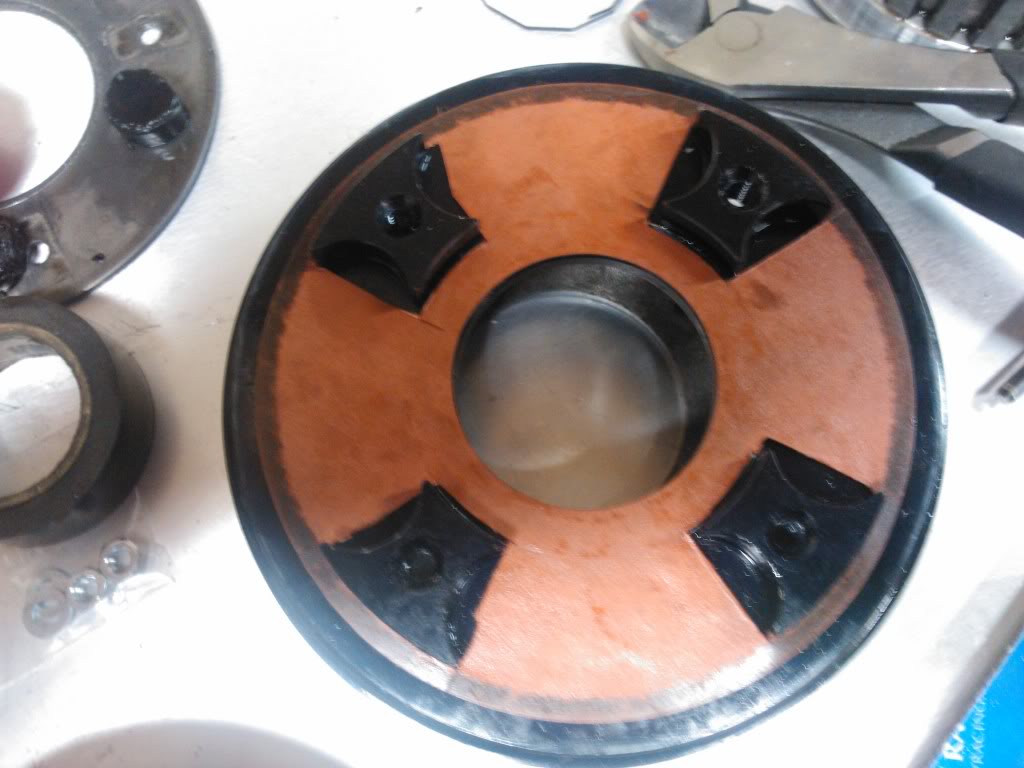

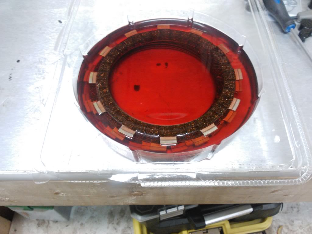

Fiber plates soaked in gear oil

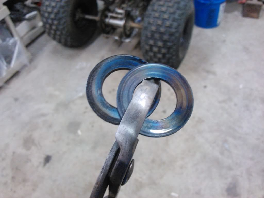

So when I went to put the clutch boss on something didn't feel/look right. Well that's because both of the thrust washers were behind the clutch boss. I don't know how long somebody ran the motor like this, but it was long enough to weld them together! I had to use map gas to get the separated.
Now on to the Boss pancake bearing I bought. Well I think that thing is a POS! I like the concepy, but not the product. So I used the ols push plate/rod and snuck the bearing and washer in there. I was getting frustrated and stopped taking pictures at this point.

Found an air leak in the billet intake. It is a 2 piece intake and seals with an o ring. I put some yamabond on it and will check it tomorrow.
