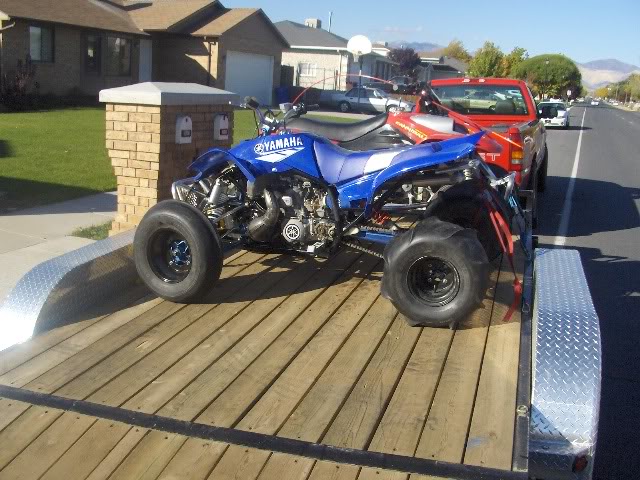

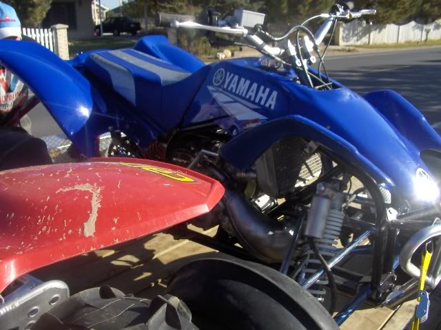

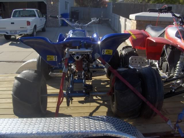

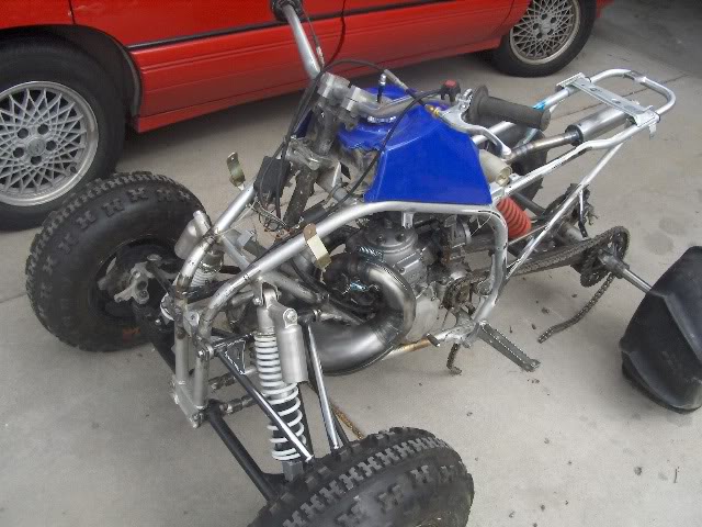

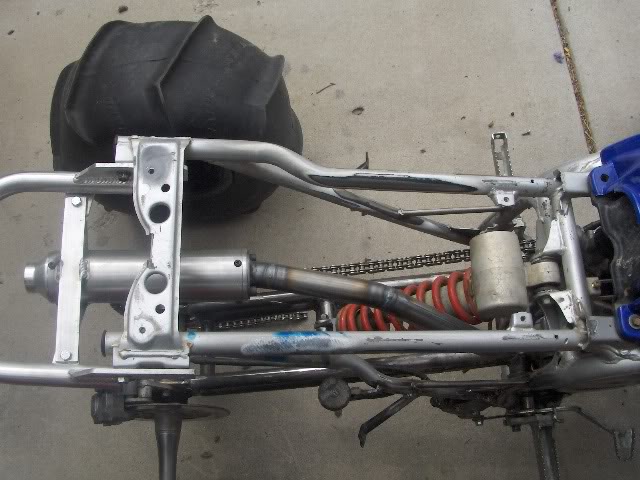

Here are some other pics.
is that pipe homemade?

I'll quote the man who built it.
yfzut said:
its got 97 yz250 motor custom built centermount exhaust. i stretched the frame a little to fit raptor a-arms and installed yfz shocks on the front and a 400ex on the rear, it has banshee rear brakes and rear axle. and raptor front and rear hubs with raptor front brakes. a 4 inch swingarm. a yfz radiator was used, all new maier plastic with the rear fenders being raptor style made to fit a banshee. alot of work, but is was fun to build and turned out to be a fast nice handling quad.
He said it ended up being 4 1/2" wider per side.
