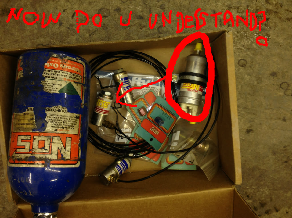

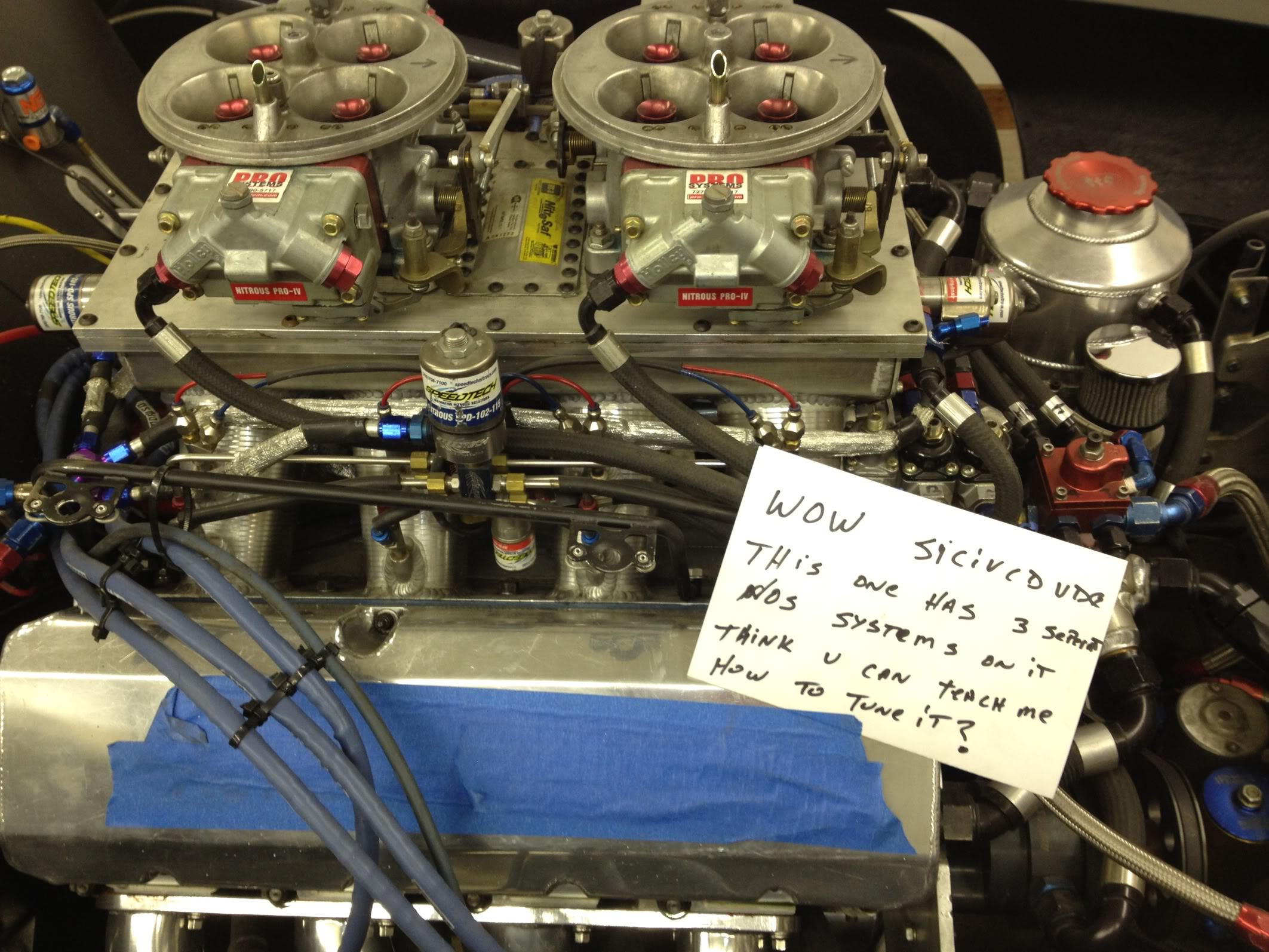

dude u seriously have no clue what the f*ck u are talking about!!!!! 4 lbs of fuel pressure is all u need an the electric pump in the pic i posted proveides that easily hell when i spray 1000 plus horsepower on all 3 of the kits they each only have 8 lbs flowing fuel pressure keep talking cause your sounding more and more stupid like u did in your welding thread !
I skipped all the chemical arguing, I will leave that to the chemists. But I do have over 10 years experience with nitrous on my race car and others I have built and tuned for friends and customers. I will say this, that kit AWK had a link to is GARBAGE! Spraying nitrous without adding the correct amount of fuel WILL BLOW YOUR sh*t UP!
1bad442, thats some serious hardware! For those that are not familiar with race engines, those are very intricate systems and your margin of error is thin. People who work on those HAVE to know what they are doing, I would listen to him people.

thanks puma at least somneone knows what there talking about in here. lol hell the second motor from reher morrison cost 80 grand i def wouldnt be spraying 3 kits on it if i thought i was gonna blow it up from not knowing what the hell im doing lol

exactly what i was saying heres a pic for u si showing what i meant
dude u seriously have no clue what the f**ck u are talking about!!!!! 4 lbs of fuel pressure is all u need an the electric pump in the pic i posted proveides that easily hell when i spray 1000 plus horsepower on all 3 of the kits they each only have 8 lbs flowing fuel pressure keep talking cause your sounding more and more stupid like u did in your welding thread !
A small low pressure pump can supply the 4 lbs necessary to keep the system working properly at a price of electricity (about 4 amps I figure) which will run on a small motorcycle battery for about 30 minutes before the battery drops below the 12v threshold and pump speed slows and fuel delivery becomes erratic. Anyone here only ride for 30 minutes at a time before stopping beside a battery charger BESIDES a dragger?
Also, you JUST suggested that you could simply hook a pingel valve into the fuel solenoid implying that that would somehow defy physics and provide 4lbs of pressure? More like about 4 inches of pressure BTW, the conversion from inches of pressure to lbs is: 1 inch of water is .036 lbs of pressure. Your fuel tank would need to be approximately 110 inches above the fuel solenoid in order to provide 4psi without a pump. Quite practical.
