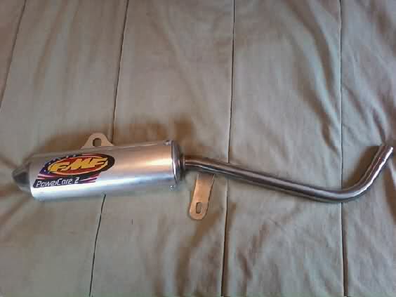

installed a brand new FMF fatty pipe and FMF powercore 2 silencer

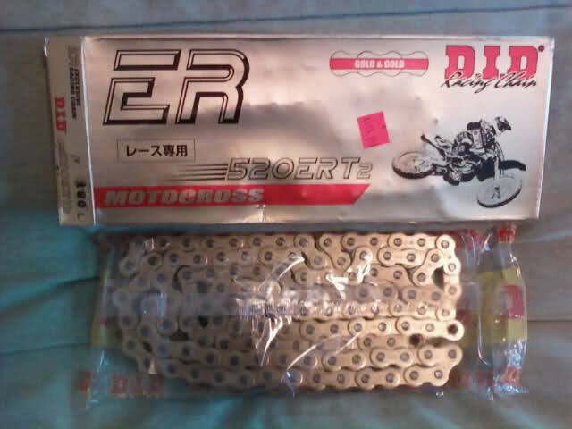

brand new racing chain
brand new front and rear sprockets, 14/40 gearing ratio

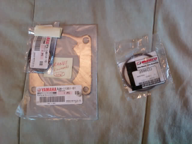

installed a wiseco top end kit, new piston, rings, all topend gaskets
installed a wiseco bottom end kit, new crank, connecting rod, oil seals, crank bearings and all bottom end gaskets

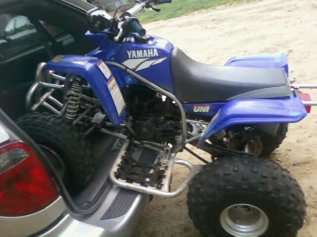

the picture of the bike is from the day i bought it, and yes it does fit in my minivan lol i take the seats out, loosen the handlebars and bend them down towards the seat and it just barely makes it in. although my kawasaki bayou 220 makes it into the van no problem
