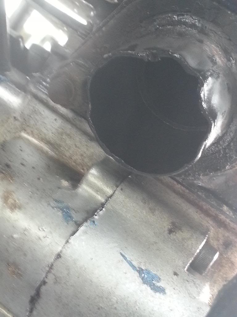

ahhhh now that makes more sense hahah. I mean its like a good millimeter of space between the exhaust and the (header?). Would I just have to shove a tone of rtv around that and throw a clamp around it and tighten the sh*t out of it?

You mean where the flange meets the pipe ?? What kind of pipe is that? Mine has a spring that pulls it to the flange .some have an o ring to seal them I think..
Do my eyes deceive me, that looks like you do not have the correct flange for the pipe to fit into.
Is there a seal or anything inside the pipe for the flange to butt up against?
It also looks like it is fitting up weiner eyed!

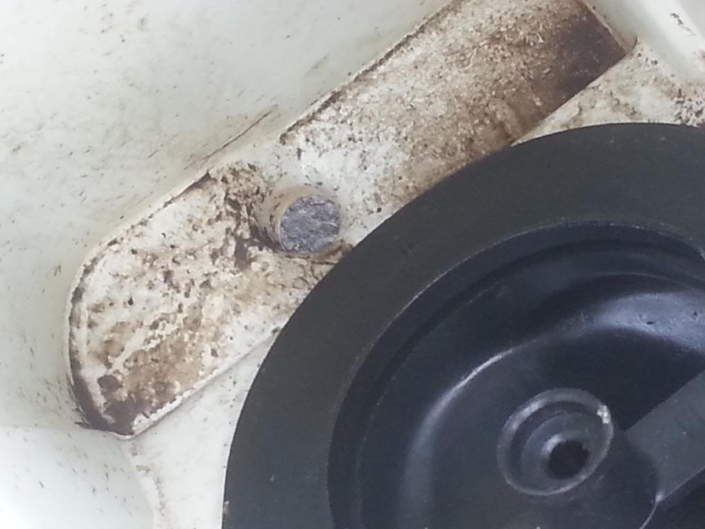

The hole on the bottom yes.. There used to be a Thingy on it lol.. Not realy sure how to explain it.. Its a drain.. the thingy attached to the bottom.. Let me try and find a picture.
Edit; Cant seem to find a picture.. Anyways it goes onto that hole and the end of it is pinched flat,, so if water were to get in there it could drip out but would be very difficult for water to go in that way...
I think you might need a new flange, Looks like someone got mad at that one.. you can try and go strait to Fmf,, or someone on the forum here might have one.. You might be able to get that one to work but it should have a o ring gasket/seal, and with it being wavy it wont seal right..

Your best bet is to get a FMF Flange for that pipe with the o-ring seal and spring. Get a New exhaust gasket also.
Then its done right, and you have that monkey off your back.
