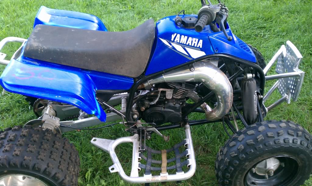

hello all blaster guys and girls im new here and this is my first post here, i have a 02 blaster with 01 engine, with mods such as 3 mm stroker, ( i believe 30 mm carb, weisco piston ported and polished jug , head milled .30 bored over .60 cylinder , v force reeds oil block off kit, dyno port pipe and exhaust , barnettes clutch, adjustable timeing plate ( not sure what it does? any one help there?) 14 tooth sprocket in front and 38 in back, ( good or bad?) +4 inch swing arm, uni air filter, itp t-9 rear wheels , maxxis razr tires, dg nerf bars twist grip throttle, ( looking for thumb box if any one has for sell ) blingstar front bumper, 180 lbs of compression, runs on 110/93 octane fuel , my question after all that is, if i got a big bore kit? vitos or any other? 240's? would it make diffrence motor wise? power wise? worth the money? id like a bigger big bore, but.. everyone says it will over heat? any statements?

that is a realy nice set up you have there. let's see some pix. the adjustable timing plate is to retard your timing to get more power. but whoever ported the topend would have the best advice for where to put the timing
hmm im try up load pics now, it doesnt look to cool, lol im looking for race cut plastics, so i can do the " look" aspect but loading pics now,
try'd uploading but wouldnt do it some reason, im go try take pic now and send to email and upload that way :) please give me second
Easiest way to upload pics is to create a free photobucket account . Upload your pics from your computer , or from your web phone . Copy and Paste the HTML code found by right clicking the picture you want to upload and select " properties " Then go to Blasterforum , click on this thread , hit add reply , then at the top of the message box , 7 images from the left , click it and you will have a box appear that you just paste that html code into and submit the message . Your pic will appear in the message .
that is a really nice setup. Next on the list for me, if it was my bike, would be 35mm airstriker carb, and too add a small piece of pipe between the airfilter and carb. I.E. a velocity stack.
how much those run ? and what would it do for my blaster power wise? and what kind peice between carb and intake? sadly i try'd selling her, but prices for these things drop majorly to fast , any one have parts for sell? ( thumb throttle, bigger carb, custom plastics? or know where to get any of these cheap ? i cant post in wanted section yet ) also thanks for uploads :)
you should be able to get a 35mm airstriker carb on ebay for around 100 bucks on a good day. airstriker is better but non airstriker is fine also. And those carbs are made by pwk i think. Now for the velocity stack, all you need is a piece of pvc pipe about 4-6 inches in length that can fit into the rubber adapter that is currently on that carb and able to fit the carb on the other end. Velocity stacks add turbulence to the air when going entering the carb and assist in atomization of the air and fuel.
