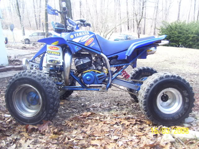

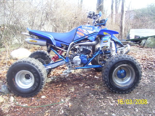

May 2008 BOTM Entries
Status
Not open for further replies.
A Arms: ASR +3 up 1
Swingarm: Swingarm shop +4 Powder coated silver
Steering Stem: Stock
Axle: Polished stock
Carrier: Stock
Locknut: Polished stock
Hubs F|R: Stock
Bars: Powder coated stock
Throttle/Clutch Lever: Magnum EZ pull
Grips: Scott Hurricane
Bumper: DG
Grab Bar: Custom +2
Pegs: Custom double wides w/kick-ups
Front Shocks: 06' YFZ450
Rear Shock: 06' Stock
Brake Line: Stainless
R Brake : 03' CBR600RR
R Rotor : 03' CBR600RR
Rims F|R: DWT .160
Tires F|R: F/ 22" Maxxis front pro's R/ 20" Kenda Dominators
Body:
Frame: Stock, modded to fit the motor
Plastic: Maier
Graphics|Seat Cover: 79' YZ400 w/ Hurricane Hannah bolts! / stock seat
Bar Pad: 79' YZ400
Fuel Tank: Stock
Engine|Drive System:
Cylinder|Head: Flotek ported. Milled / rechambered head w/o-ring groove
Bore & Stroke: 83mm x 75mm
Displacement: 406cc
Cam: R U serious?
Carburetor: Polished Keihin 38mm air stryker RDZ meth converted w/billet oversize bowl and powerjetted
Air Filter|Box: K&N w/outerwears cover / CFM airbox
Pipe|Silencer: Trail- YZ400 DG pipe. Quadzilla FMF silencer. Drag- Custom FTZ Racing out of frame pipe
Clutch|Plates: Flotek pro-lock Banshee clutch w/Banshee TZ bearing mod on the pusher
Gearing F|R: 15/40
CDI|Ignition|Killswitch: YZ400 CDI/ Nology coil and hot wire/ Tusk tether kill
Reeds: Custom Mototasinari V-Force 3's
Cooling: AIR
Reactions: TRblaster

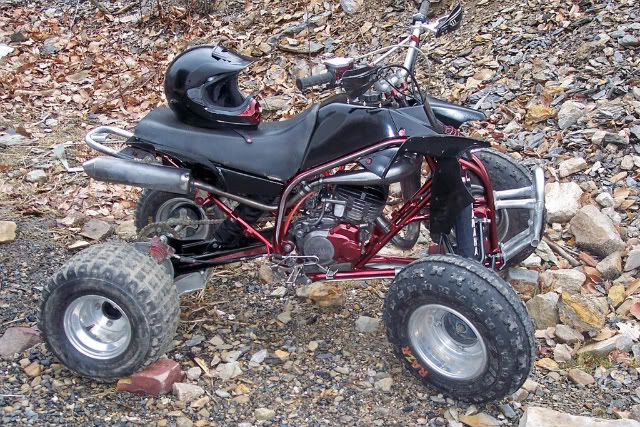

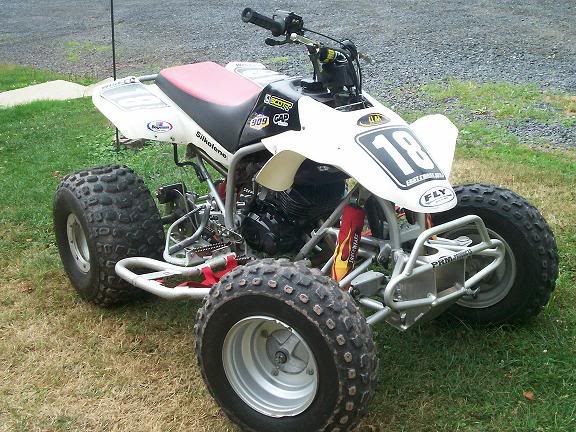

  1. A Arms: stock
  2. Swingarm: stock
  3. Steering Stem: stock
  4. Stabilizer: n/a
  5. Axle: stock
  6. Carrier: stock
  7. Locknut: stock
  8. Hubs F|R: stock
  9. Bars: stock
  10. Throttle/Clutch Lever: Motion Pro I:I
  11. Grips: BMX grips
  12. Nerfs: n/a
  13. Bumper: n/a
  14. Grab Bar: Custom basket w/ box made to fit
  15. Front Shocks: stock
  16. Rear Shock: stock
  17. Brake Lines: stock
  18. Rotors F|R: n/a
  19. Rims F|R: stock
  20. Tires F|R: 4max, knobby
  21. Other: custom made wheel spacers, diamond plate heel guards!!!I:I
Body:
  1. Frame: stock
  2. Plastic: stock
  3. Graphics|Seat Cover: stock
  4. Number Backgrounds: n/a
  5. Handguards: n/a
  6. Bar Pad: pipe foam
  7. Fuel Tank: stock
  1. Cylinder|Head: stock
  2. Bore & Stroke: 0.10 & stock
  3. Displacement: stock
  4. Cam: n/a
  5. Carburetor: stock
  6. Air Filter|Box: Twin air
  7. Pipe|Silencer: stock
  8. Clutch|Plates: stock
  9. Gearing F|R: 13/40
  10. CDI|Killswitch: stock
  11. Cooling: air

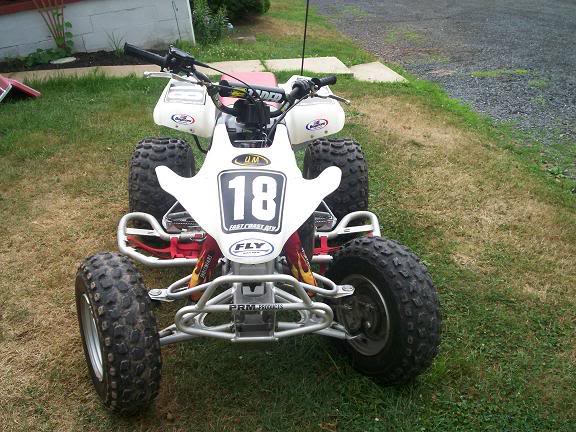

1. A Arms:stock
2. Swingarm:stock
3. Steering Stem:stock
4. Stabilizer:stock
5. Axle:stock
6. Carrier:stock
7. Locknut:stock
8. Hubs F|R:stock
9. Bars:protaper
10. Throttle/Clutch Lever:stock/carbon fiber (not shown in picture)
11. Grips:progrips
12. Nerfs:n/a
13. Bumper:stock
14. Grab Bar:stock
15. Front Shocks:stock
16. Rear Shock:stock
17. Brake Lines:stock
18. Rotors F|R:stock
19. Rims F|R:front stock stock
20. Tires F|R:front stock
Body:
1. Frame:stock
2. Plastic:specail edition
3. Graphics|Seat Cover:stock
4. Number Backgrounds:stock
5. Handguards: stock
6. Bar Pad:stock
7. Fuel Tank:stock
1. Cylinder|Head:stock
2. Bore & Stroke:stock
3. Displacement:200
4. Cam:stock
5. Carburetor:stock
7. Pipe|Silencer:fmf
8. Clutch|Plates:stock
9. Gearing F|R:stock
10. CDI|Killswitch:stock
11. Cooling:mud n/a
12. Other:n/a

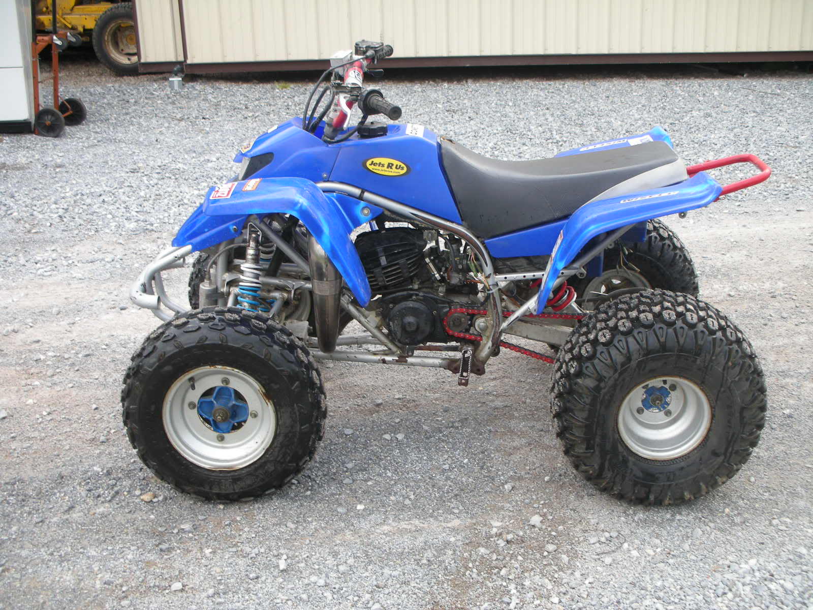

A Arms: stock with diamond j +6 widening kit
Swingarm: +4 swingarm shop
Stabilizer:
Axle: stock
Carrier: polished stock
Locknut: stock
Hubs F|R: stock
Bars: renthal
Throttle/Clutch Lever: polished, stock
Grips: skull
Nerfs: none
Bumper: dg moto plate
Grab Bar: ac racing
Front Shocks: yfz 450
Rear Shock: 400ex
Brake Lines: motion pro
Rotors F|R: stock
Rims F|R: abused and beatup stock, itps
Tires F|R: stock, razrs
Body:
Frame: painted
Plastic: cut fronts
Graphics|Seat Cover: none
Number Backgrounds:
Handguards: cycra stealth
Bar Pad: renthal
Fuel Tank: stock
Cylinder|Head: stock, head milled 0.30
Bore & Stroke: .60, stock
Displacement: 198cc???
Cam: somebody let know when they find a cam!
Carburetor: stock w dyno jets
Air Filter|Box: ready filter
Pipe|Silencer: full sh*tty fmf power core2
Gearing F|R: 14/40
Cooling: cfm scoops
Reactions: cbaber

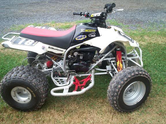

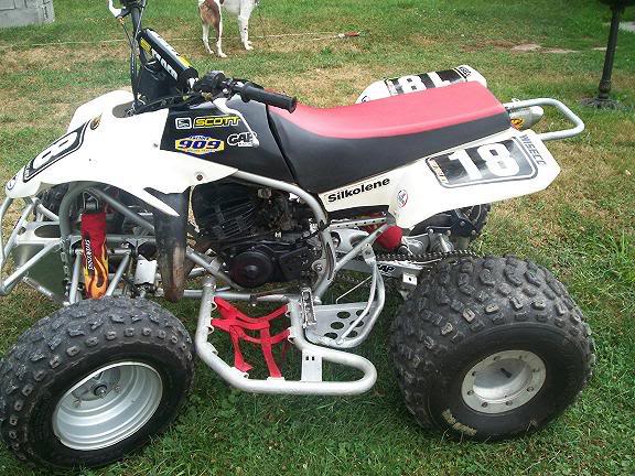

1. A Arms: Stock
2. Swingarm: Stock
3. Steering Stem:
4. Stabilizer: n/a
5. Axle: Stock
6. Carrier: Stock
7. Locknut: Stock
8. Hubs F|R: Stock
9. Bars: Red fly
10. Throttle/Clutch Lever: Stock
11. Grips: scott
12. Nerfs: n/a
13. Bumper: stock
14. Grab Bar: red idk
15. Front Shocks: works w/ rezzies
16. Rear Shock: trx450r
17. Brake Lines: Stock
18. Rotors F|R: Stock
19. Rims F|R: stock
20. Tires F|R: f 22 x 8 i think r pro trak 21 x 7r 10
Body:
1. Frame: Stock
2. Plastic: Stock
3. Graphics|Seat Cover: Stock
5. Handguards: n/a
6. Bar Pad: fly
7. Fuel Tank: stock
1. Cylinder|Head: bored .20 over stock head
2. Bore & Stroke: 66.5 X 57mm
3. Displacement: 198cc i think
4. Cam: lmfao 2 strokes don't have cams
6. Air Filter|Box: uni airfilter
7. Pipe|Silencer: pro circuit full
9. Gearing F|R: 14/40
11. Cooling: air
12. Other: v force 3 reeds and reed spacer

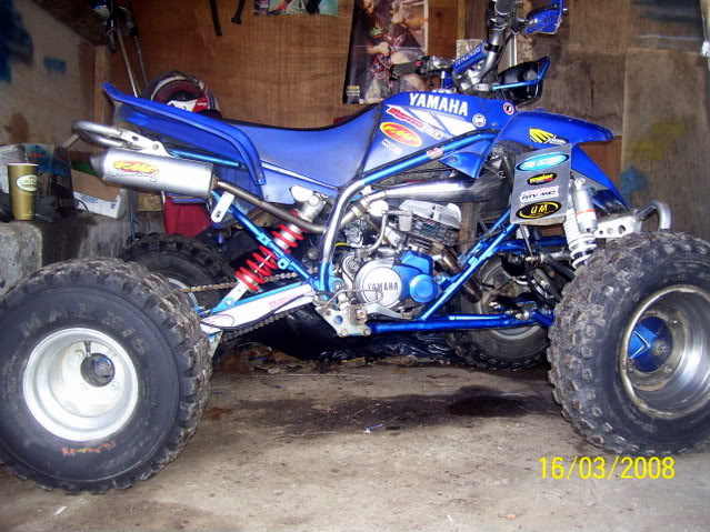

A Arms:stock with 1.5 wheel spacers
Swingarm: +4
Stabilizer: none
Axle: stock with 3.5 wheel spacers
Carrier: stock
Locknut: stock
Hubs F|R: stock
Bars: renthal
Throttle/Clutch Lever: streamline braided steal
Grips: cheap aftermarket maker ?
Nerfs: none
Bumper: dg
Grab Bar: ac
Front Shocks: banshee
Rear Shock: stock for now
Rotors F|R: stock
Rims F|R: all itp aluminum
Tires F|R: maxxis razrs
Body:
Frame: stock, painted
Plastic:stock, cut and painted
Graphics|Seat Cover : none
Number Backgrounds : none
Bar Pad: renthal temp lost
Fuel Tank: stock
Cylinder|Head: stock polished
Bore & Stroke: .80 over, stock
Displacement: ????
Cam: duh!!!
Carburetor: stock with vitos
Air Filter|Box: k&n filter stock box
Pipe|Silencer: full fmf fatty w/ power core 2
Gearing F|R: 14/39
Cooling: custom air scoops
Other: boost bottle, timing advanced
