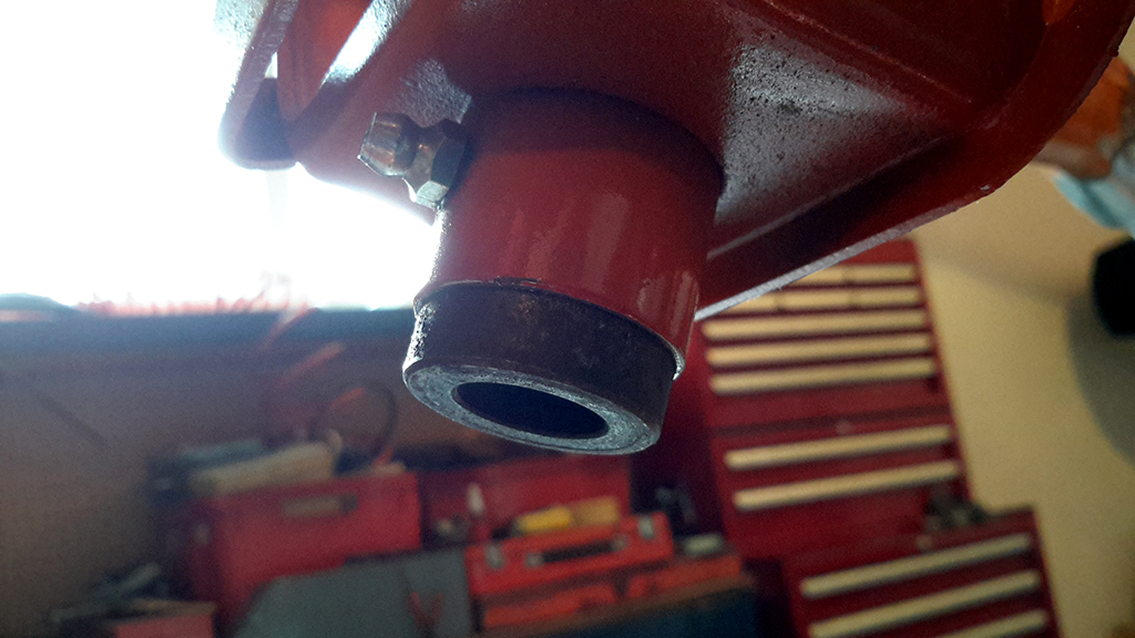

Any tips on removing the bushing things in the lower stem mount?
Thanks
Wouldn't socket and hammer be used for installing them.
Any ways. I removed the grease nipple and then used a punch and hammer to remove the lower bushing and then the top bushing.

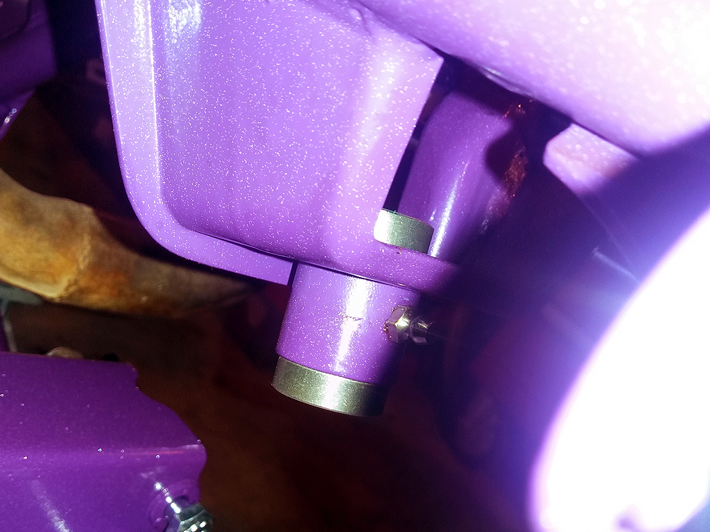

I ordered 2 new stock oem ones today and will get measurements off them and might look into making the o-ring type.
Anyone that is looking at replacing the bushes. 2 are needed.
YAMAHA 90381-15040 - BUSH, SOLID
LOWER STEERING STEM SHAFT BUSHING

Just a warning. When you install new bushes may have to remove some paint/powder coat off your frame where the bushes sit on. You also may have to machine a little bit off the bushes to make them if. I have to do this on my blaster and I was installing a after market stem also. Check everything goes together and moves nicely. Also lube the o-rings and the shaft part of the stem before installing so you don't cut or take a bit out of the o-rings when you install the stem.
