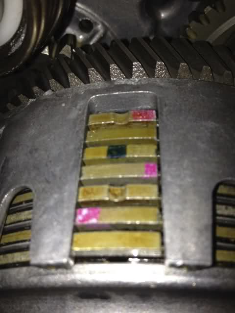

ScottSchwarzer New Member Apr 16, 2012 92 1 8 North Carolina Jul 17, 2012 #1 Are the notches shown on the fiber plates supposed to all line up or something? I don't have them in line as you can see...
Awk08 Administrator Staff member Technician Jan 30, 2009 24,427 2,291 175 Jul 17, 2012 #2 only the tabs on the steel plates are important, they should skip every 2 or 3 slots first one at 12 o'clock, next at 3, then 6 and so on as long as they are pretty evenly spaced out, not stacked all in one spot
ScottSchwarzer New Member Apr 16, 2012 92 1 8 North Carolina Jul 17, 2012 #3 Okay awesome. I followed a many a video and instructional on the forum so I have the steels spaced out and dots and all aligned. Thanks!
