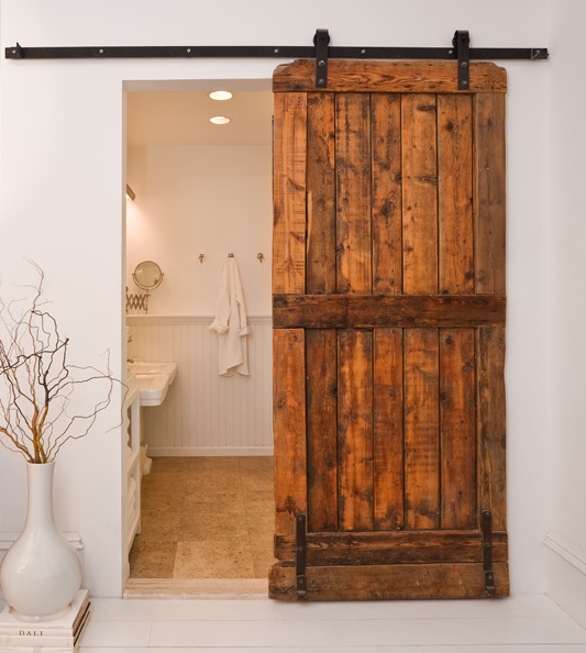

And I think I will be doing a sliding door on the pantry and laundry that share a track, so only one can be open at once. Something like this

That sliding door ^^ looks great. That would add some character to any home.
