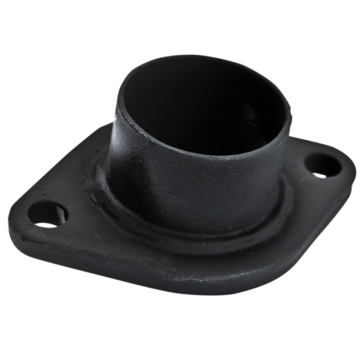

Hey I just got an entire fmf exhaust system and it didn't come with a flange so does anyone know the diamiter of the header?
Are you talking about the flange that bolts to the engine. Like this:
Yes you will most likely need to up your main jet. Do you know what it is now ? Any other mods you have ?
Plate part that mounts to engine is 85mm x 58mm and is about 4-5mm thick. 2 holes 70mm apart center to center, pipe part is 23mm long x 38mm OD x 35mm ID
