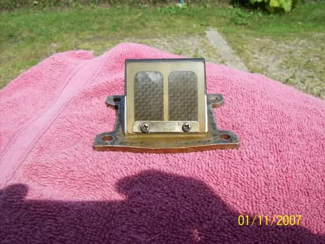

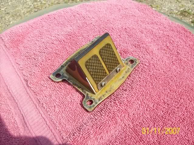

Here's what my Boyesen power reeds look like, you can also look on e-bay to see what different ones look like. Hope this helps helps ya.
