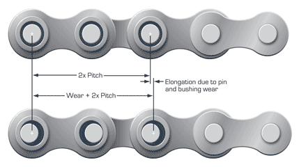

This is mostly true, but if you use a chain gauge or following the manufacturers stretch measurement and replacement guidelines you can replace many chains to a set of sprockets. It is done in industry all the time and by many racers in the know. Most of us try to get a bit more use out of a worn chain and it is that stretch, the increase in the chain link distance, that takes the life out of the sprocket.
Here is a fair article on chain wear limits.
I do not agree with his well educated opinion about "O"ring chains taking almost no power,
but his "Second Method" is my standard method of measuring chains.
You can make up your own 24 link chain gauge like the one he has pictured, although I would recommend a 15-5/32" replacement length.
Replace your chain at this wear length and your sprockets will last a very long time. Go longer and and you will need sprockets too.
One may get away with fitting a new chain on comparativly new sprockets.
But if a sprocket has some wear, especially the small one, it will have worn to accommodate the chain that has been running around it.
If you now fit a chain with a tighter link spacing (as in a new one) to that worn sprocket, the longer sprocket spacing will bunch the chain.
What happens now is that there are less links contacting the teeth taking the strain which causes the links that are in contact work much harder.
Fitting an old chain to new sprockets will cause the chain to ramp and tightening occurs putting extreme stress on every link.
Which ever way you go, old chains will stuff new sprockets and new sprockets will stuff old chains.
Eventually both will stuff each other.

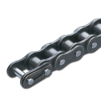

The fact you have to keep tightening it is telling you that it is wearing out and destroying your sprockets.
The links and rollers are soft and wearing like in this picture:
They have little case hardening. It has nothing to do with ultimate strength.
A good chain will only need a couple of adjustments in a season. Beyond that you are just destroying sprockets.
