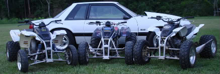

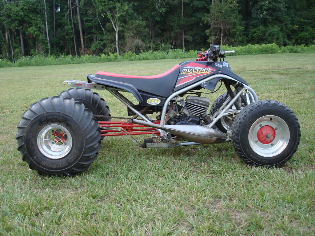

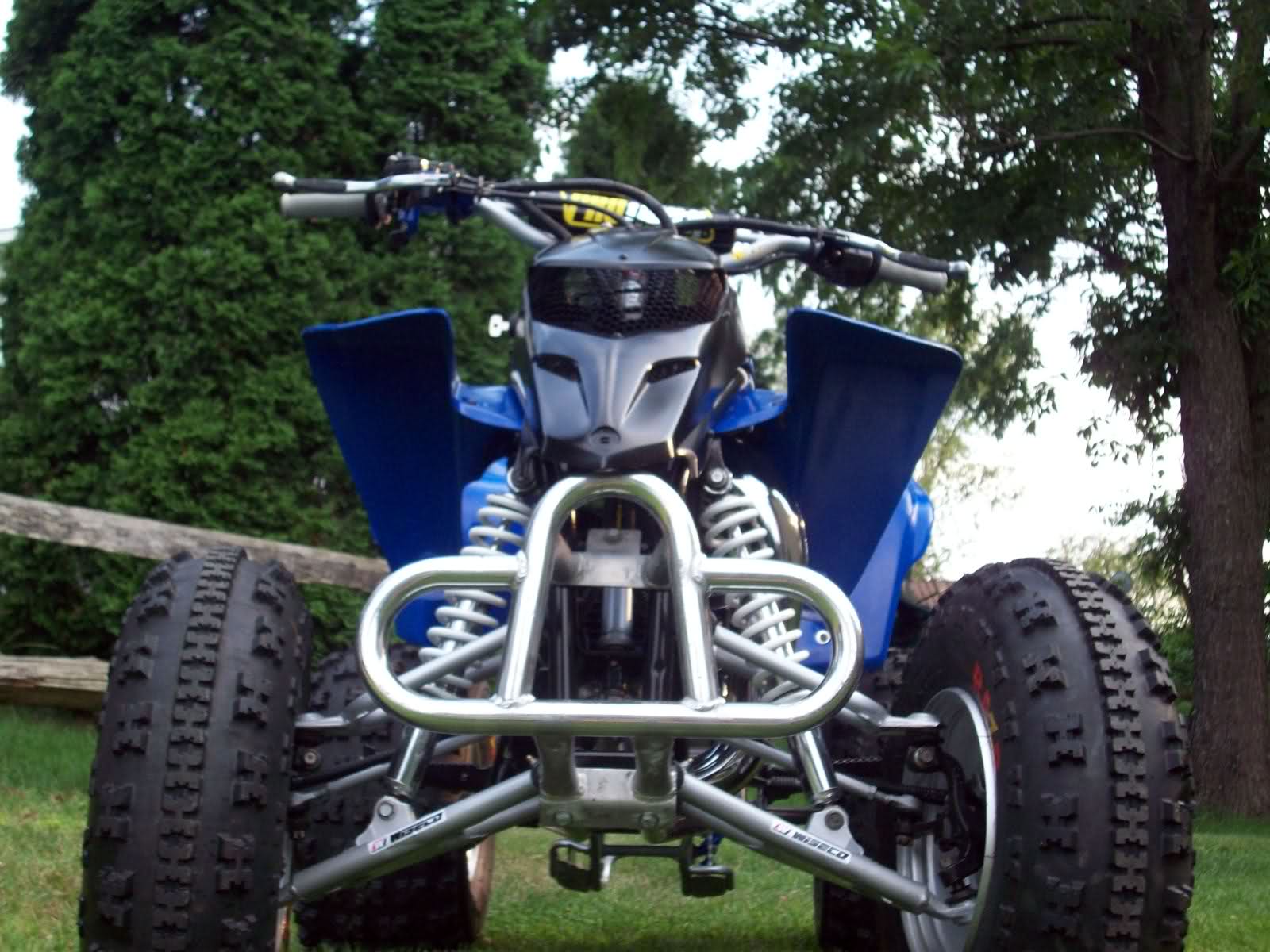

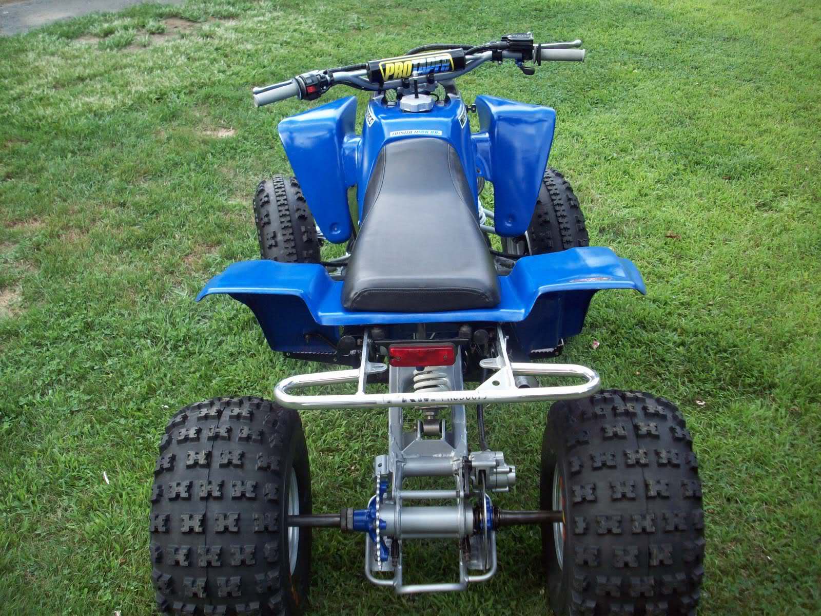

OUR BOTM
A Arms: stock
Swingarm: custom +12
Steering Stem: stock
Stabilizer: n/a
Axle: stock
Carrier: stock
Locknut: stock
Hubs F|R: BANSHEE
Bars: striaght drag
Throttle/Clutch Lever: MOOSE
Grips: scott
Nerfs: n/a
Bumper: Removed
Grab Bar: DG
Front Shocks: Front Struts
Rear Shock: Rear strut
Brake Lines: CROSS CUSTOM
Rotors F|R: STOCK
Rims F|R: DOUGLAS 125's
Tires F|R: SCOOTER Fronts PRO-WEDGE II rear
Body:
Frame: Stock LIGHTENED
Plastic: Factory CUT
Graphics|Seat Cover: STOCK
Number Backgrounds: n/a
Handguards: n/a
Bar Pad: n/a
Fuel Tank: stock
Engine|Drive System:
Cylinder|Head: CT racing 240 big bore|
Bore & Stroke: 72MM x +3MM
Displacement: 244cc
Cam: n/a
Carburetor: 38mm Keihn Airstryker
Air Filter|Box: clamp on k&n
Pipe|Silencer: RDZ out of frame(right side)
Clutch|Plates: Hinson Basket| Barrnett
Gearing F|R: 15|38
CDI|Killswitch: Pro
Cooling:
Other:Flotek Drag port and polish, Loflin flywheel lightening,PRO DESIGN Adjustable stator plate, v-force 3 reeds, WCR OVER RIDE TRANS, TRENGA
HYDRO REARS. HERE IS THE TRANSFORMATION OF ZACKS' BLASTER

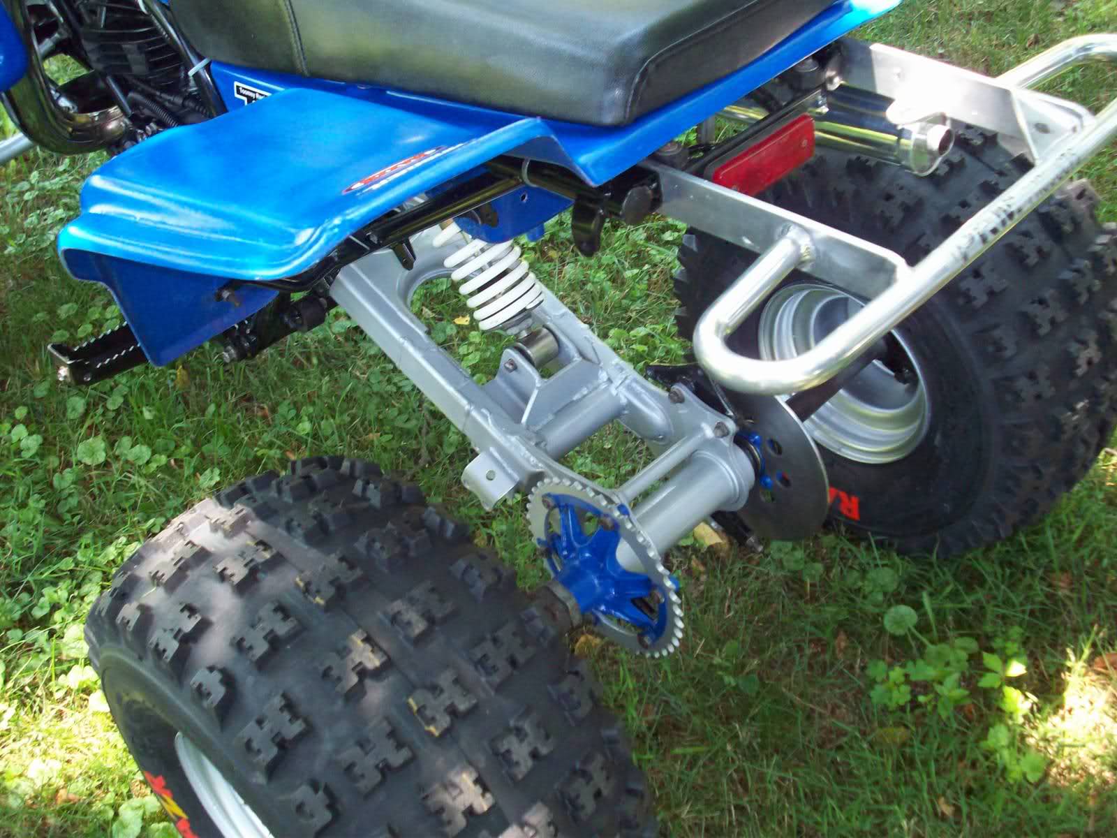

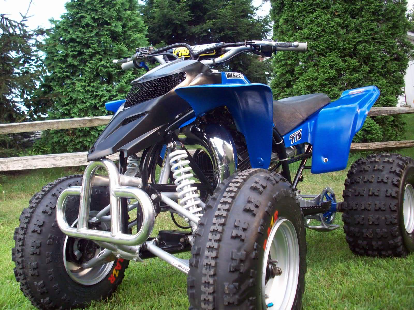

A Arms:stock / Metallic Silver
Swingarm: +2 / Metallic Silver
Steering Stem: stock / Metallic Silver
Stabilizer: na
Axle: stock
Carrier: stock / Metallic Silver
Locknut: stock
Hubs F|R: Durable Hubs-Black/ Stock
Bars: protaper se
Throttle/Clutch Lever: MSR Grip Levers
Grips: renthal
Nerfs:yfz50 heel guards
Bumper: DG
Grab Bar: PRM
Front Shocks: stock
Rear Shock: stock
Brake Lines: stock
Rotors F|R: stock / stock
Rims F|R: stock / stock
Tires F|R: Maxxis Razrs (Front & Rear)
Body:
Frame: stock / Gloss BLack
Plastic: 03 Custom Screened Hood / Gloss BLack
Graphics|Seat Cover: Leather Seat Cover
Number Backgrounds:
Handguards:
Bar Pad: protaper
Fuel Tank: stock
Cylinder|Head: Bored .40 w/ Wiseco Pistons
Bore & Stroke: 3mm Hotrod Stroker Crank
Displacement: 198
Cam: na
Carburetor: stock
Air Filter|Box: Ready Racing Filter
Pipe|Silencer: Tommey B1
Clutch|Plates: EBC Dirt Racer Clutch Kit
Gearing F|R: 14/40
CDI|Killswitch:
Cooling:
Other: Boyeson Pro Series Reeds, Modquad Reed Spacers, FloTek Port & Polish, K&N Jet Kit, YFZ450 Foot pegs

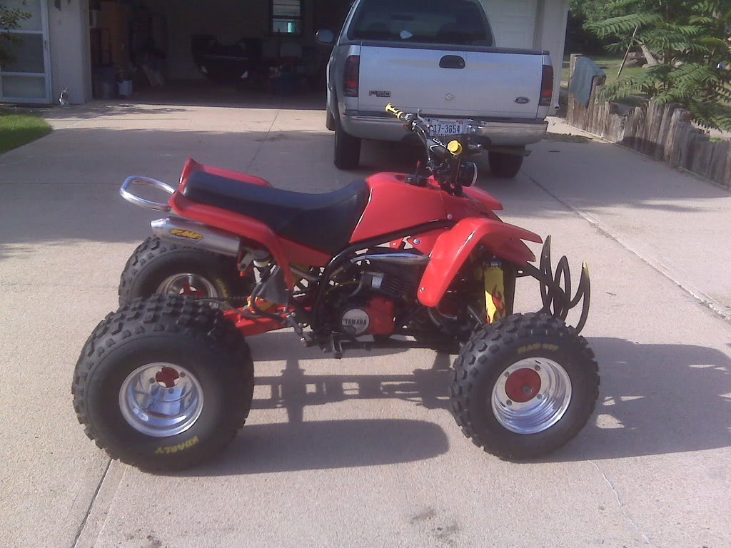

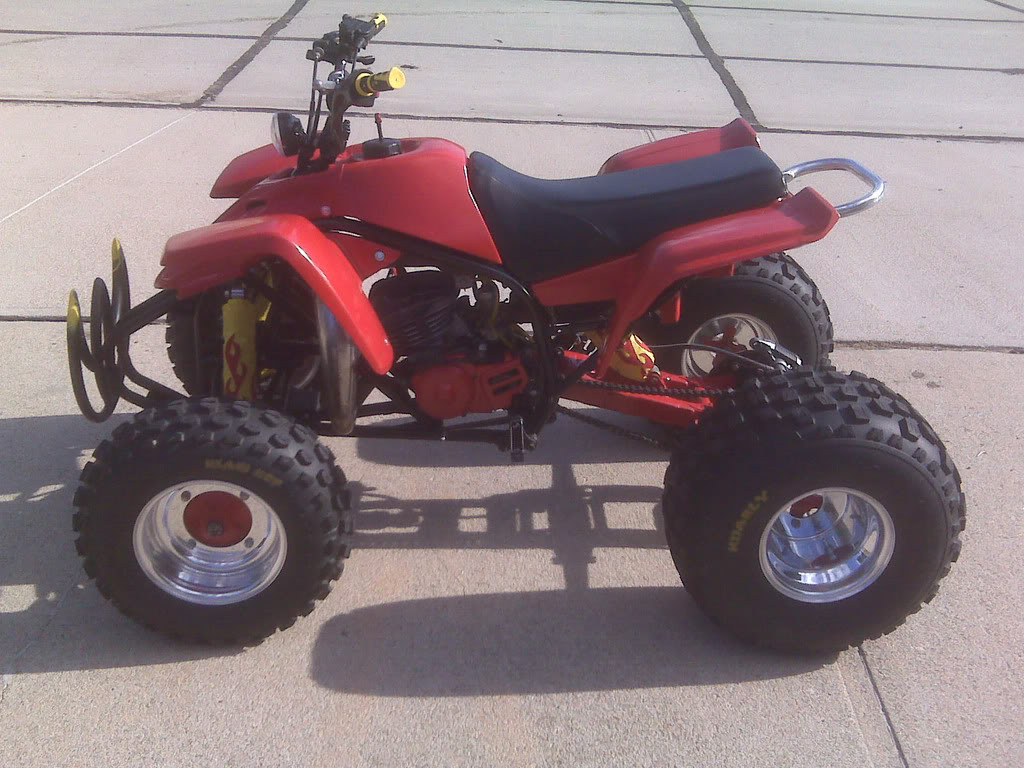

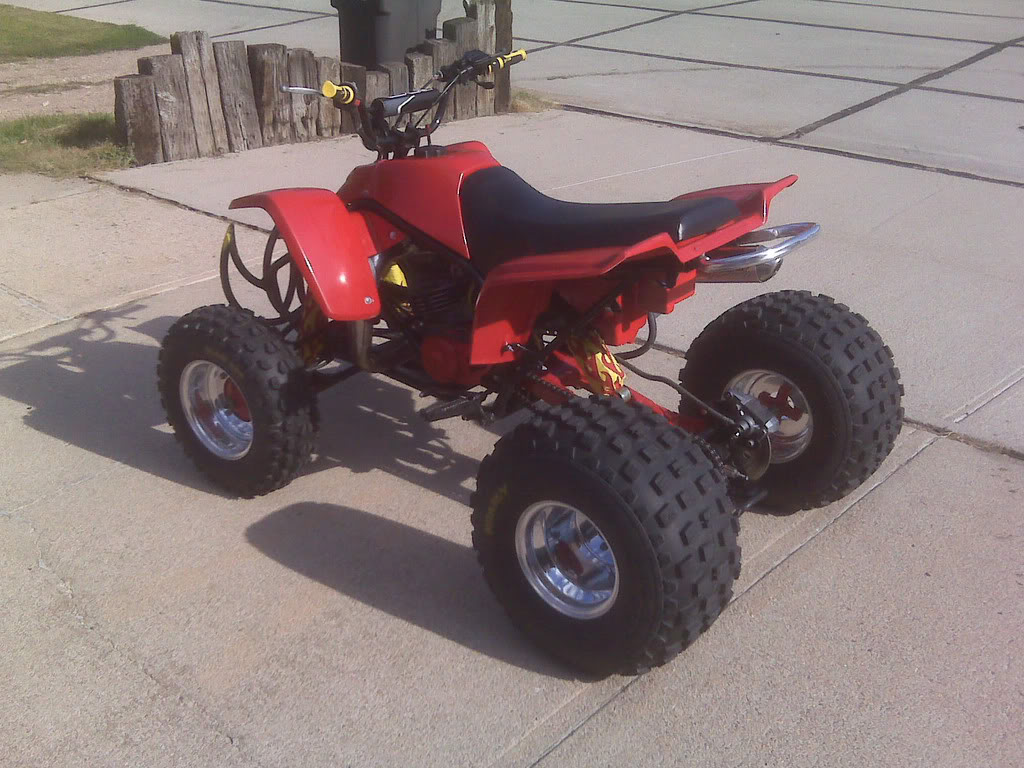

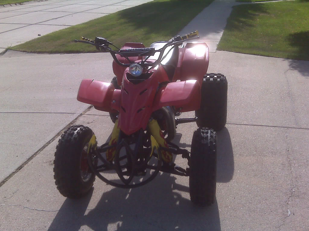

1995 Evil Blasterd
1. A Arms: stock - gloss black
2. Swingarm: Custom fabricated extended +4 w/ stock shock mount position, gloss red
3. Steering Stem: stock - gloss black
4. Stabilizer:n/a
5. Axle: stock - polished
6. Carrier: stock - gloss black
7. Locknut: stock
8. Hubs F|R: body color - gloss red
9. Bars: MSR Carbon Steel MX handlebars
10. Throttle/Clutch Lever: stock
11. Grips: Pro Grip 964 EVO - yellow/black
12. Nerfs: n/a
13. Bumper: custom fabricated "horn" style using stock bracket - black/yellow
14. Grab Bar: custom fabricated and polished aluminum
15. Front Shocks: stock - PINK! - yellow/red flame shock covers
16. Rear Shock: stock - PINK! - yellow/red flame shock cover
17. Brake Lines: hydraulic rear / stock cable fronts
18. Rotors F|R: stock
19. Rims F|R: polished aluminum Douglas .160 front and rear
20. Tires F|R: Kenda Klaw XRC 21x7x10 fronts - Kenda Knarley 22x11x8 6 ply
Body:
1. Frame: gloss black
2. Plastic: painted - gloss red / Maier front custom hood (03' Style)
3. Graphics|Seat Cover: custom sewn black vinyl
4. Number Backgrounds:n/a
5. Handguards: n/a
6. Bar Pad: MSR
7. Fuel Tank: stock - gloss red
1. Cylinder|Head: Bored .20 over - WSM Platinum piston
2. Bore & Stroke: 66.50mm - 57mm
3. Displacement: 198cc
4. Cam: upside down
5. Carburetor: stock
6. Air Filter|Box: stock box - NoToil filter - lid removed
7. Pipe|Silencer: FMF Fatty Gold Pipe - FMF PowerCore II silencer
8. Clutch|Plates: Tusk clutch kit - heavy duty springs
9. Gearing F|R: 14/40
10. CDI|Killswitch: stock
11. Cooling: wind and mud
12. OTHER: TORS, Oil Injection removed. Gearside and Flywheel covers painted body color. Custom Street Bike Hydraulic brake caliper and master cylinder. Custom stealth tail light. Custom headlight. 32:1 Yamalube premix w/ 91 non ethenol. Cup Holder installed under seat for long trail rides ;)
