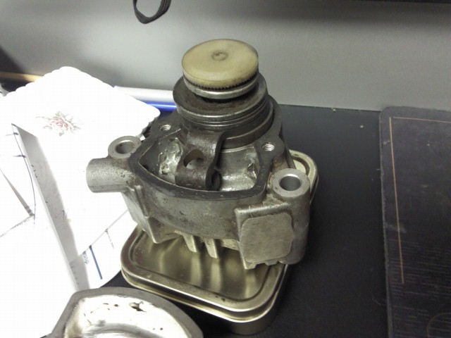

Here is what it looks like on the inside.
Yea u put the fist pad in with the aligning pin. No prob there. It's the other pad that you have to slide into the caliper is the one that I'm having trouble with. I have the manual n have been following it to do the pads
hmm.Thats strange.Its possible you have a poor manufactured pad.Like in the pic above pull the guts completely out and try to fit the pad.And also in the pic above do you see the plastic gear.If you lift up on this part so its not engaging the gear and turn it to one side or the other should be able to adjust it so the bolt on other side allows for the larger thinkness.In my mind seems this is what is interfearing with pushing the pad in.Its hard for me to see one pad fits and the other dont.Do they look like they have the same diameter.Do you have calipers available.
In all honesty I was a bit dumb founded at first for a min when changing my pads last week for the first time.Then the light turned on lol.But yeah first measure the pads radiouse and the bore on the caliper.Its hard to explain this one is a hands on thing.Took me a minute myself.
yea........i cant even get the pad started into the bore. it doesnt have anything to do with the adjuster. everything is out of the caliper. i put the smaller pad with the pin in, then try to back in the 2nd pad and it wont enter the bore at all. its gotta be a poor manufactured pad. well i have it stuck now in the caliper. ill drill it out and order OEM pads
