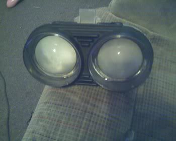

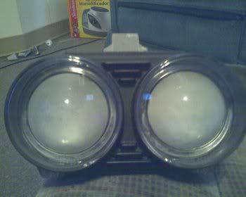

heres a set i did for a buddy who has a 400ex. there lexus sc400 projectors with 16w bulbs. super bright, light up the whole river.

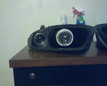

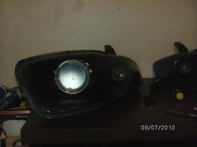

heres the same style lexus projectors in my cavaliers headlights (first set)
(second set) lexus lows and bosch highs

his 400ex's with no extras cost me 150 to build using new oem projector units, and a new lexan lense. in the end i charged him 200 and had 6 hrs of labor into them.

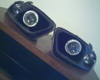

heres a pic of the ones im working on for my blaster
bosch projector like the ones in my headlights. led back lit, with a super white led halo
