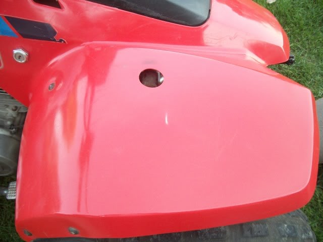

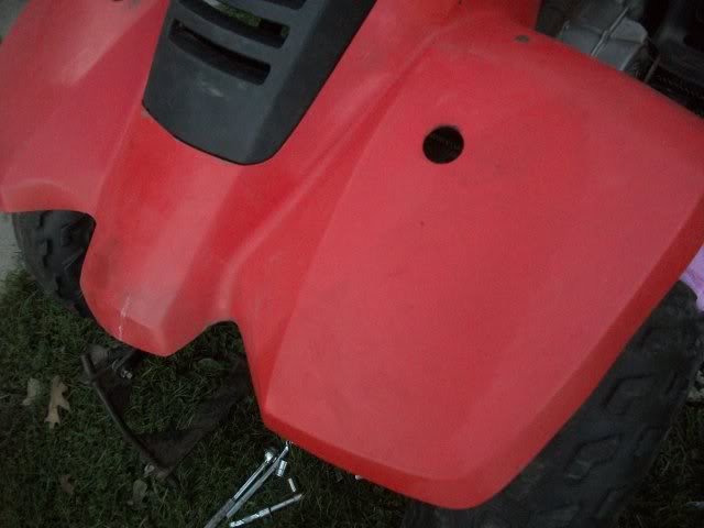

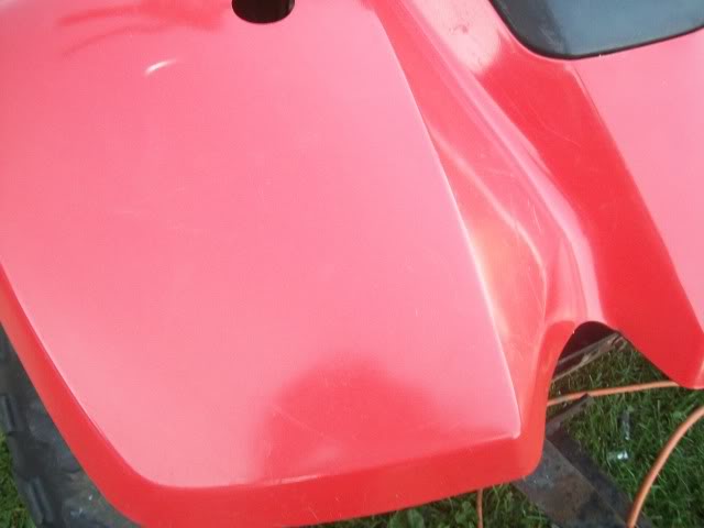

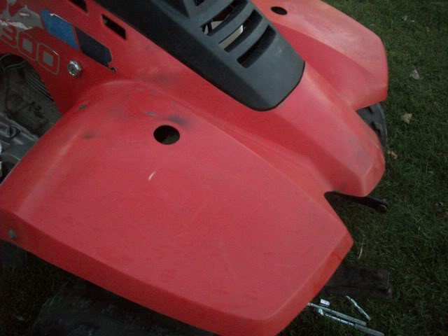

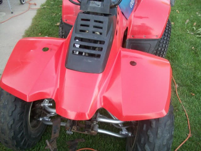

I use novus 2 and a buffer, to polish the plastic on my atv's.
It works great. the more time I take, the better it looks.
K, guys, You ask and shall recieve.
Here is before and after pictures. this is on from my suzuki lt300.
BEFORE
AFTER
