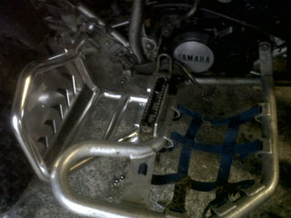

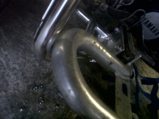

so they came in the post today had to drill a few holes to get them to mount to the upper mount on the frame, but now when i get them to mount to the peg the nerf bar hits at the back of the heel guard and wont come down to match the mounting holes, heres some pictures...
double foot pegs may solve that.
cut the mounts off another set of pegs and bolt or weld them behind your existing set, then the heels to that. that'll move the heels back far enuf to clear the nerfs.
but you'll need to redo your upper mount to accomodate the new rearward position.
the set on my black work good for my yfz heelgaurds with those same style nerfs

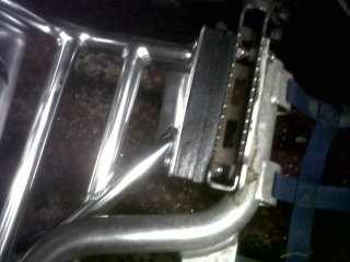

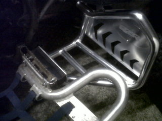

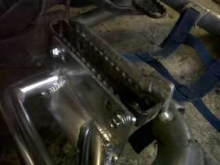

so i didn't have time and the money to go buy another pair of foot pegs, soo what i done was cut out 2 pieces of wood cut them to size, marked and drilled the holes out, sprayed it black lol, turned out good though, had to extended the heel guards back a good bit on the frame mount and then got it all bolted up, actually is quite good, less weight and actually looks well, still has a wee bit of touching between the nerf bar and the heel guard but will do for now. I:I
Heres some pictures :)
not sure how long wood is going to last exposed to water and mud ?
but nice improvising !
the paint on the wood will help, and easily replaceable even if it rots out ofter a year or so
Yeah that's what i was thinking, need to get a big long bolt now though because there's a bolt holding the heel guards and wood to one side of the peg then the nerf bars to the other side was tight getting the two bolts to fit in with each other.
