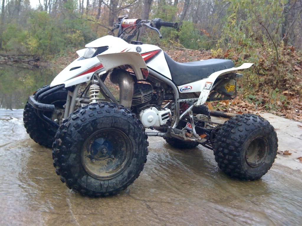

2001 Blaster
1. A Arms: stock
2. Swing arm: custom +4 (black)
3. Steering Stem: stock
4. Stabilizer: na
5. Axle: stock
6. Carrier: stock
7. Locknut: stock
8. Hubs F|R: stock
9. Bars: stock
10. Throttle/Clutch Lever: stock
11. Grips: Yamaha
12. Nerfs: na
13. Bumper: stock (painted black)
14. Grab Bar: custom (painted black)
15. Front Shocks: stock
16. Rear Shock: z400
17. Brake Lines: stock front, motion pro +4 rear
18. Rotors F|R: stock
19. Rims F|R: stock
20. Tires F|R: balloons
Body:
1. Frame: stock
2. Plastic: Race cut (305 style), 04 hood
3. Graphics|Seat Cover: stock
4. Number Backgrounds: 652
5. Hand guards: stock
6. Bar Pad: pro taper
7. Fuel Tank: stock
Engine|Drive System:
1. Cylinder|Head: stock/stock
2. Bore & Stroke: stock (wiseco piston)
3. Displacement: stock
4. Cam: stock
5. Carburetor: stock (vitos jetting, and power reeds)
6. Air Filter|Box: Yamaha/ lid off
7. Pipe|Silencer: pro circuit
8. Clutch|Plates: stock
9. Gearing F|R: 12/40
10. CDI|Killswitch: stock
11. Cooling: stock
12. Other: RC chain, painted stator and oil pump cover, custom cut kick starter

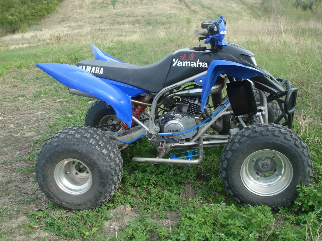

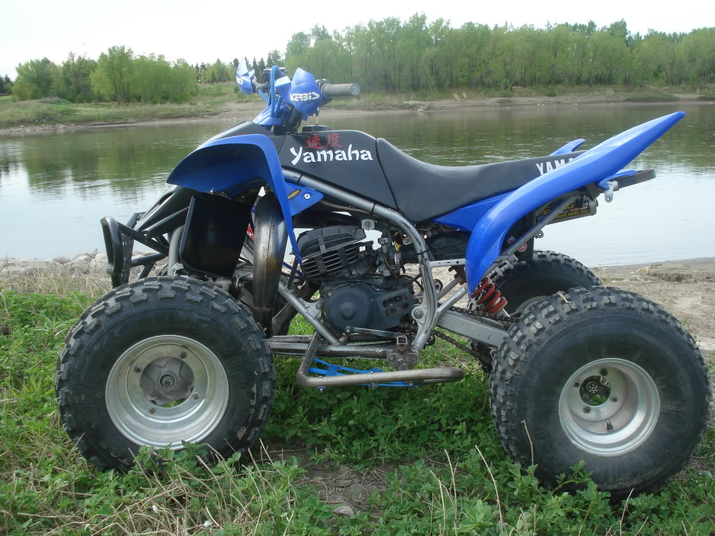

lol
-. A Arms: stock with custom skids
-. Swing arm:stock plus my custom swinger that isnt finished
-. Steering Stem: stock
-. Axle: stock with 1.5" spacers
-. Bars: Moose race Bend
-. Throttle/Clutch Lever: stock
-. Grips: Pillowtops
-. Nerfs: DG steel with blue nets
-. Bumper: Blingstar
-. Grab Bar: custom bent
-. Front Shocks: Progressive banshees
-. Rear Shock: 400ex
-. Brake Lines: Teflon, motion pro +4 rear
-. Rotors F|R: stock and squeaky
-. Rims F|R:ITP T9's
-. Tires F|R: Kenda Dominators
Body:
-. Frame: stock Grey
-. Plastic: Maier Race front fenders, 04 hood and light, Raptor 700r rears
-. Graphics|Seat Cover: custom chinese yamaha/ Crock Skin(not pictured)
-. Hand guards: Acerbis blue MX
-. Bar Pad:Moose racing
-. Cylinder|Head: Kennedy ported 240 cylinder/Kennedy cut Head
-. Bore & Stroke:72mm big bore piston/ Stock crank
-. Displacement: 240
-. Carburetor: Keihin 35mm Airstryker
-. Air Filter|Box: Fully custom box,Scoop, Aluminum outerwears box lid, K&N filter
-. Pipe|Silencer: Fmf Fatty/PC silencer
-. Clutch|Plates: stock with Belray Gearsaver
-. Gearing F|R: 14f 39r
-. CDI|Killswitch: stock
-. Cooling:Custom Airscoops
-. Other: Chrome oil pump cover & clutch cover,trailtech endurance
