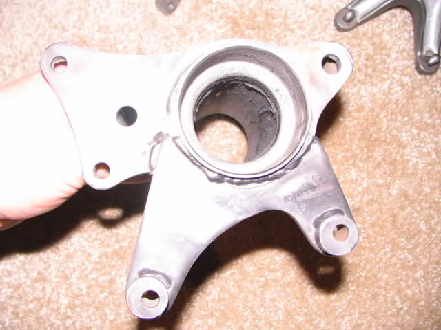

You need to shim both sides of the shee carrier to make it work.Not a good idea,as ken stated it will shift out of alignment and be bad news.The best thing to do is cut the brake boss off of the shee carrier and weld it to the blasters 88-02 carrier nad you will be all set.I have done this and still run one this way and works out perfect.If you need pics just lmk.

yup all the same. i posted another thread about this but i do want to see pics dualstroke. please pretty please
^^^^^^^That is a stock blaster 88-02 carrier with a banshee brake boss cut off of a shee carrier and welded to the blaster carrier.Works great and alot cheaper than an 03-06 carrier.If you need more lmk
