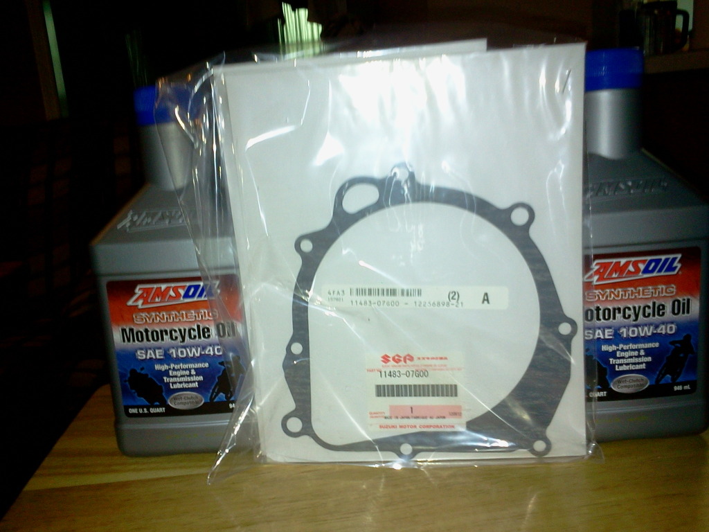

well looks like im gonna buy a new motor for my truck because its my crank bearings and not my oil pump good thing my dad got a new truck last week so I can use his old one but anyways I went to the dealer and got the gasket a 2 quarts of oil
