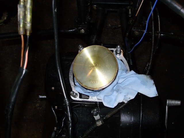

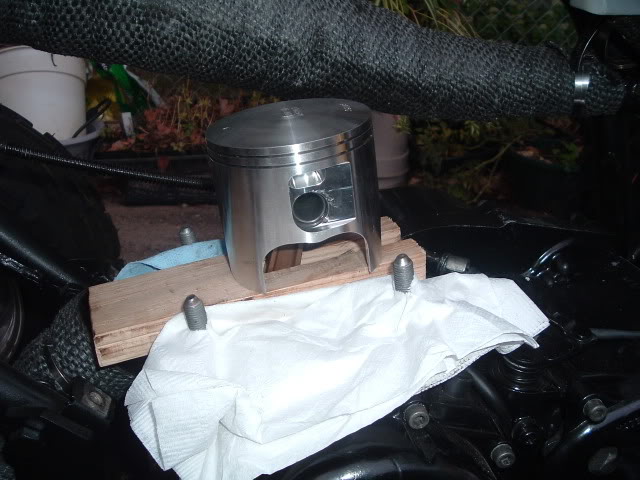

Here's my lil piston. Imagine feeling that thing eveytime it reaches the top and bottom of it's stroke @ 9000rpm's...PB
