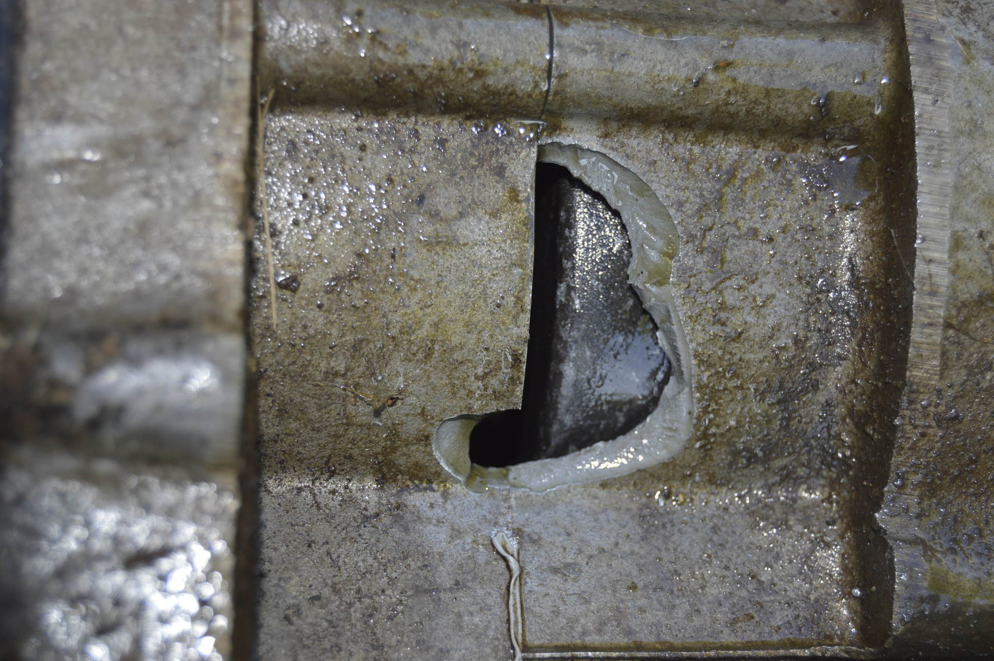

when home i took the top of and discovered the piston was broken.
i took the jug off and could see the tiles trough the crankshaft :(
onto my question,
I have the engine from my older model (needs new top and bottom end probably gearbox too)
could i build everything from the new engine in the old cases?

ok tnx everyone, i will combine the 2 engines into 1 great engine and i'll try to (TIG) weld the hole, the are more holes ''behind'' the crank (between the gearbox and the crank) piston has caused a lot of damage, bummer
