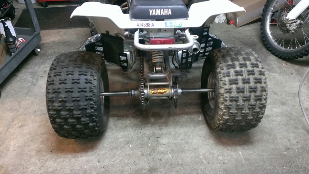

I was thinking about getting a banshee rear axle, and flipping the front in the mean time before i can purchase some a-arms. How much will the banshee axle help and what kind of a-arms would you recommend for a first a-arm upgrade? also what about spacers or a diamond j widening kit. Obviously the a-arms are the best way to go but whats so bad about the widening kit or the spacers.

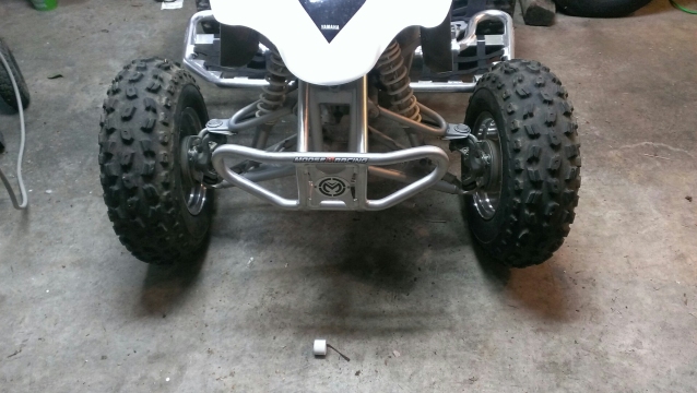

I've got +3 spacers with a Banshee axle. The whole setup cost me ~$100 and improved handling significantly. The only drawbacks I've heard of with the spacers are increased bump-steer and wear on suspension components. Some day I may upgrade to some long travel arms with YFZ shocks.
The Shee axle will give you about 3 3/4" more width, combine that with 3" spacers and that is more than 9" wider in the rear.

You can tame the bump steer introduced with spacers on the front by tweaking the toe.
I have the Banshee axle in the rear with no spacers and 3" spacers in the front (+1.5" each side). It is a bit of comprimise because it barely fits in my truck with my bike using this setup and I don't want to go much wider with all the trees we have here. Like I said it has i significant improvement over stock handling, and I didn't have to adjust the toe in or notice a lot of bump steer. The Banshee axle is an easy swap in an 03+ Blaster but needs some brake work for the earlier bikes.
