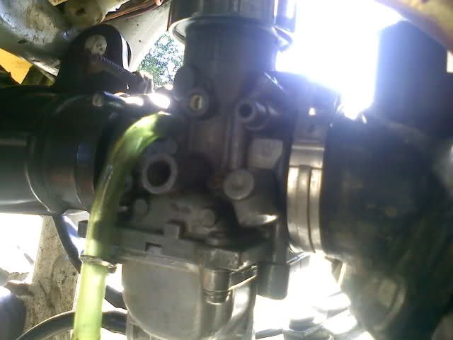

well first off i was wondering what this hole is on the right side of my stock carb...theres threads in it but nothing there, i never noticed it before, its the hole next to the green tube.

I believe that hole is where an idle screw would go if the idle screw wasn't on top of the tors unit like when you use a tors delete cap you drill and tap that hole and put a screw in it to control idle. I don't know for sure though so someone correct me if I'm wrong.

that hole on your carb should not be open to the inside, poke something in there to be sure, it must be for some other application yamaha/ect. used the same carb for ?
ok the hole isint open...not sure what its for and what would you say on my jet size, ive heard i need to be at 320 or higher and ive heard i need to be at 280??im at 300 now and about to plug chop, what would you say about the headlight...

looks like maybe the switch out of the tors box on top of the carb ????

o so its just some old part on the tors...
yes. theres probably an opening next to where the throttle cable goes into the housing on the bars where that wire use to go in. you will want to close that up if its not already so dirt doesnt get in there. i used a piece of rubber from a tire and it looks factory. you would never know it wasnt supposed to be there but you can also use rtv or some type of silicone. pretty much anything that will keep water and dirt out of there
