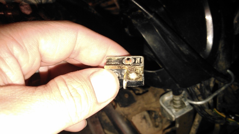

what is this switch? 06 blaster.

I bought a blaster that needed rebuilt and headlight/taillight and nuts and bolts here and there, this little switch was hanging. I don't have a clue what its for.
TORS switch. Smash it with a hammer and throw it in the trash. Then connect the 2 wires in the harness together. Save the rubber grommet. Put it back in the thumb throttle with a dab of silicone sealer in the hole.
I kinda wondered if that's what it was, the little bit I've been on the forum I've heard all about it. and that's easy enough to do lol
