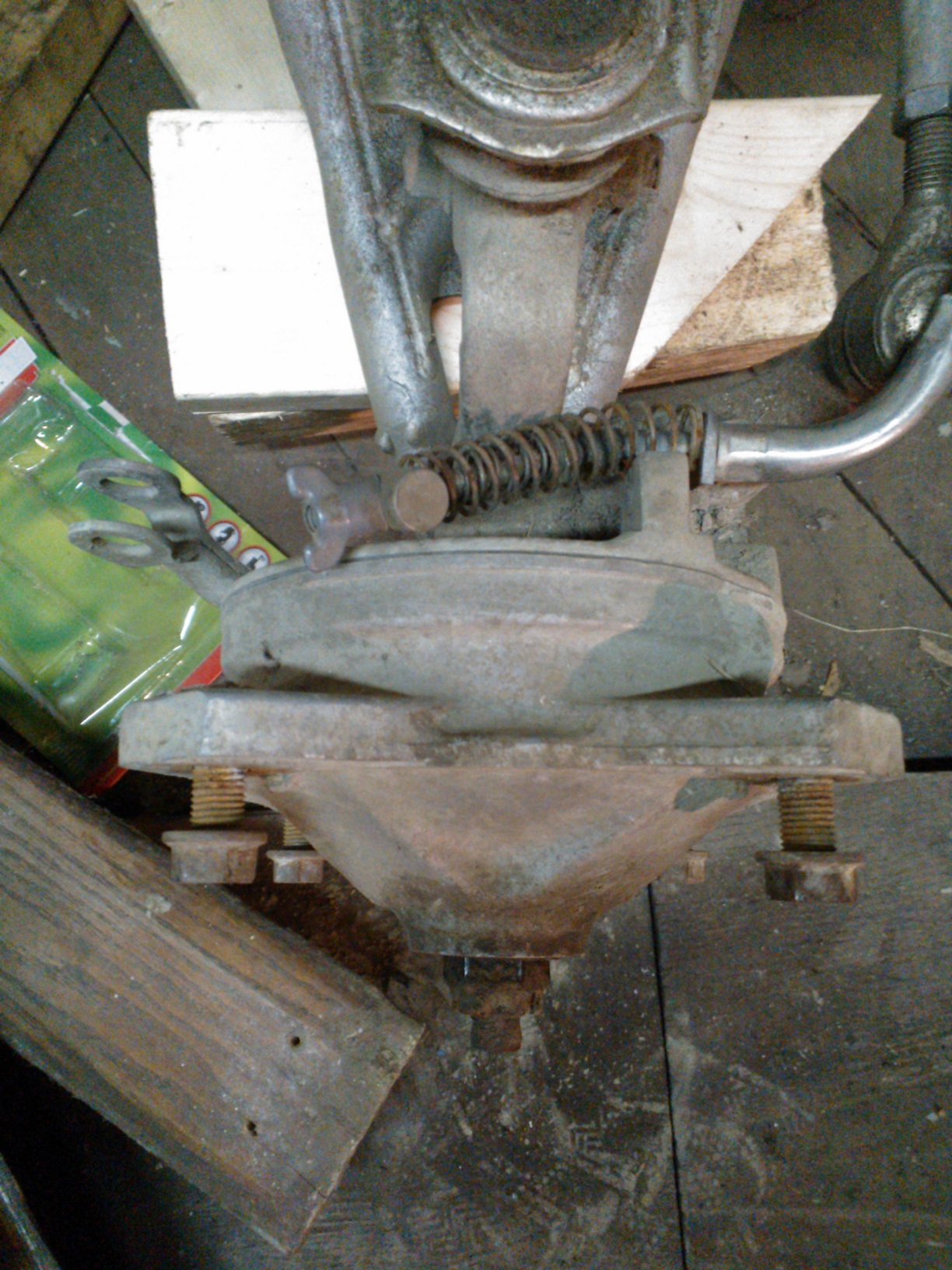

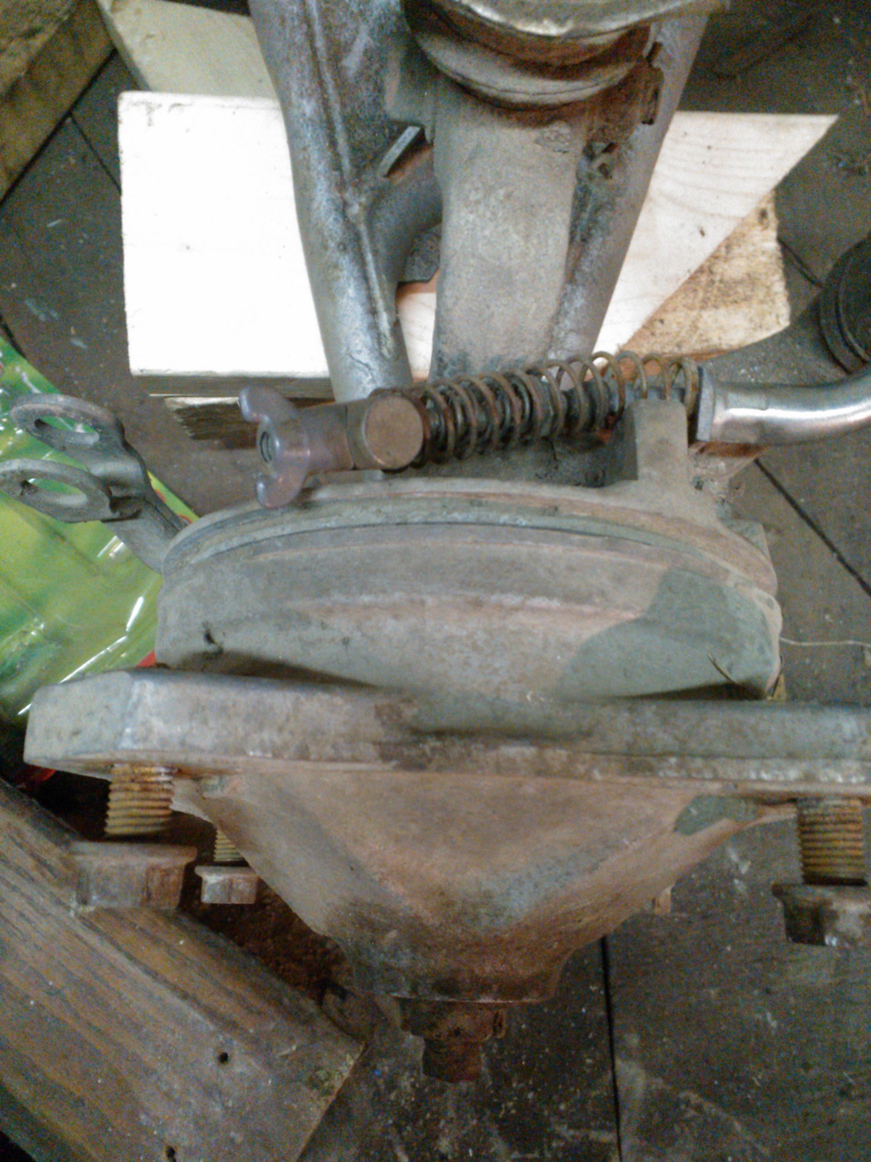

I noticed last night when I removed the front tire that the hub seemed to be alittle loose. Not like a wheel bearing loose, but the actual hub. I checked the manual and there is no washer before the nut that holds the hub on. As you can see from the pictures, theres a good quarter of an inch play in the drum. Is this just because the washer is not there?
(Yes I know its all rusted to hell, it did go through Hurricane Irene :eek: )
