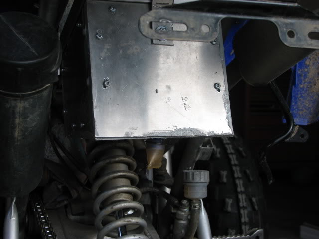

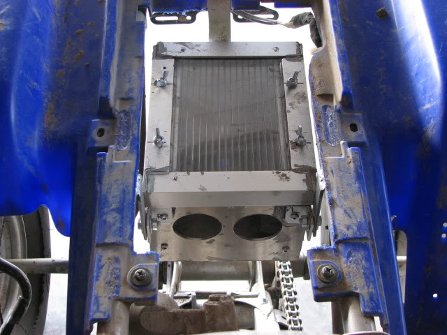

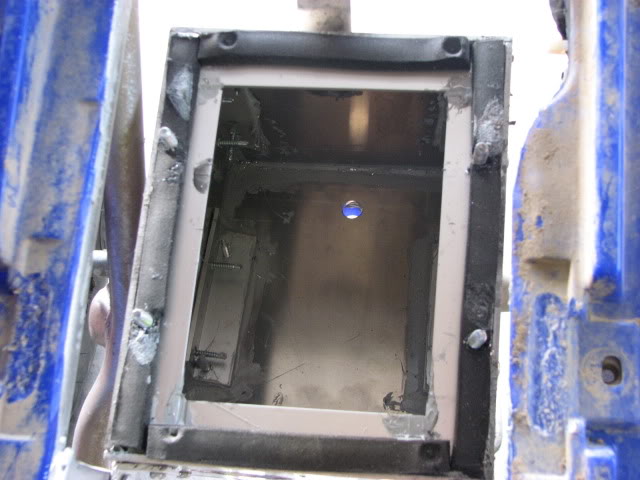

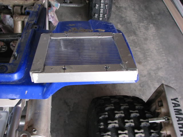

So, I had some 1/8" 6061 aluminum around and I built one. I don't have access (or know how) to TIG, but some aluminum angle, some screws, and some automotive body adhesive/seam sealer does the trick too!
I still need to put in the fittings and pipe for the intake snorkle and the pipe down to the carb. I'll do that when I get my top end back from Wildcard.
It's not the prettiest, but it's weather tight, very sturdy, quite light weight, and should breathe good enough to leave the lid on.

There will be a 2" ID snorkle running up from the right side hole up close to where the factory snorkel was with a rubber splash shield. The other side will have a fitting with a Uni clamp-on filter on it with a 2" ID pipe to the carb.

you could have just used some clear silicone and it would of looked a bit cleaner
Yeah I could have, but this stuff is AMAZING. Incredibly strong bond. It's a structural adhesive made for metal that is subject to vibration, not just a sealant. I don't care too much that it's not pretty. I don't usually ride around with my seat off looking at the airbox :D
