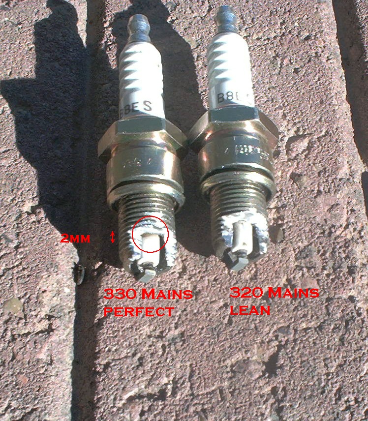

Spark plug chop
Wow! learn something new everyday. Being new the the 2-stroke world, and doing a bunch of read'n on here- I should probably buy and four pack of plugs. I never heard of this, But everyone seems to agree this is the way, I would of just looked at the plug without cutting it and probably been wrong. Now for a newb question, this goes for any blaster stock to modded?

so basically for a plug chop you need to waste a bunch of plugs to get it running right? i am going to have to try it cause i think i have too big of a main

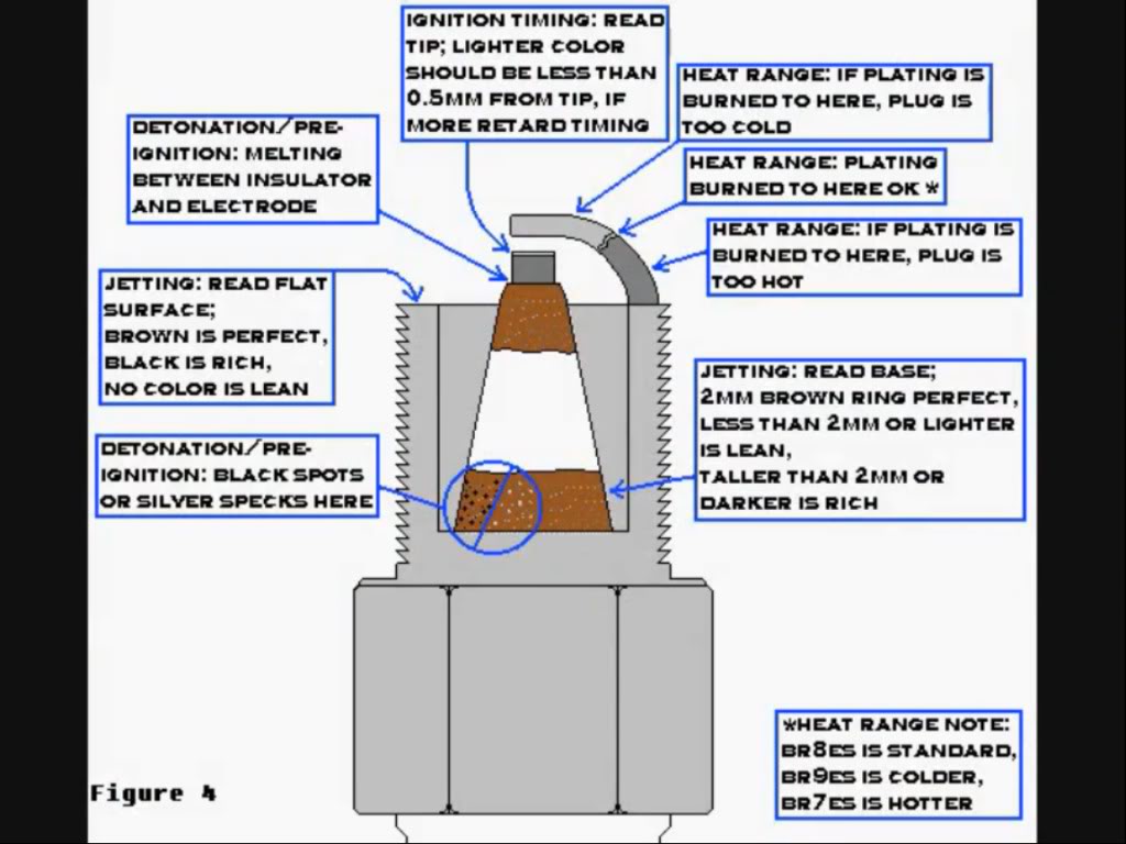

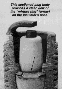

How you can read spark plugs and select them - by Gordon Jennings.
http://www.blasterforum.com/do-yourself-20/how-plug-chop-38674/
How To Read Your Spark Plugs, They Are Telling You What’s Going On in There | Rays-Shop
2-Stroke Plug Chop How-to
From plug check - Honda TRX Forums: Honda TRX 450R Forum
Three times more info than most of us need but good reading:
Triple Carburetor Tuning

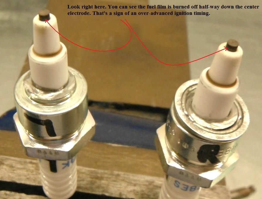

Perfect jetting with timing too far advanced:
From: jetting / plug chop pics - USA 2strokers

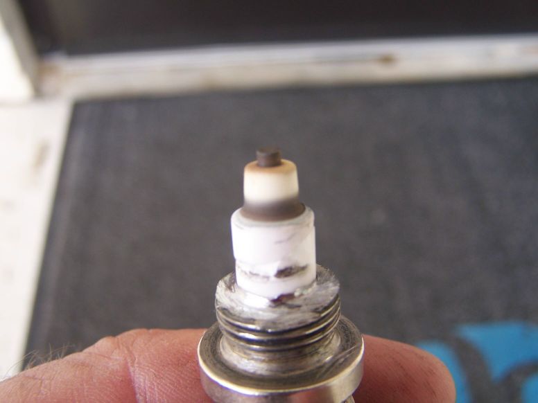

Rich:

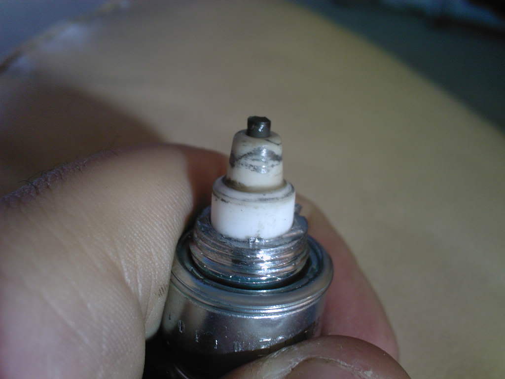

Pretty good:

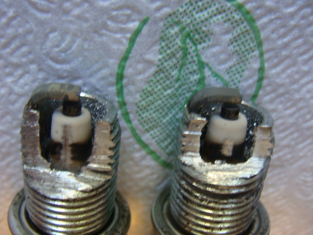

LEAN <DANGER>:
Oh, and one more. I really like this one, points out the difference between plug temp range and mixture:
http://www.roost.si/articles/jetting/
