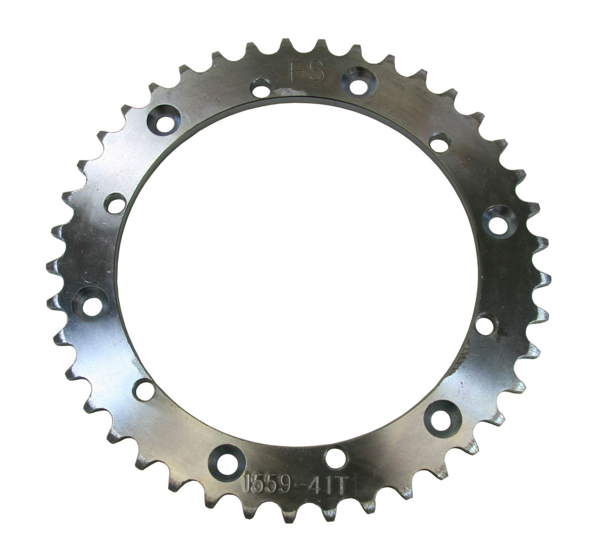

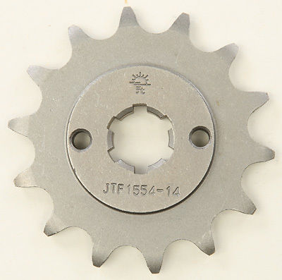

Find out what sprockets you are running and what your brother has. Should say the number of teeth on the sprocket Or just count them. Should look like this:

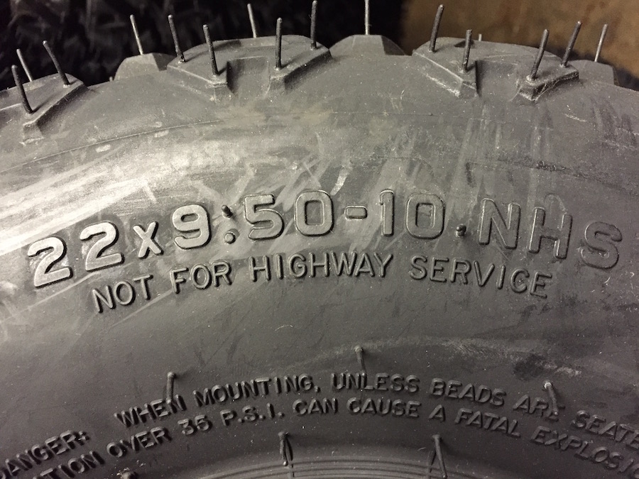

Also the rear tyre size check your tyre size and your brothers. This info is on the side of the tyre.
Give us that info and it will help.
