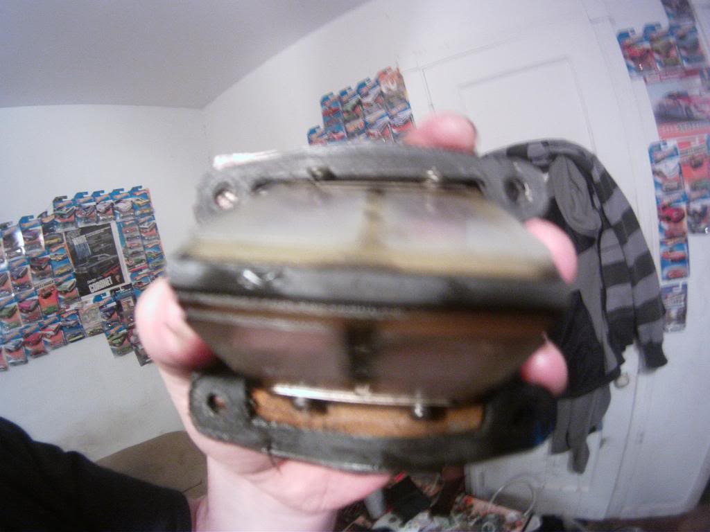

After spending my saturday working on my new blaster the longest I was able to get it running was for 30 sec. It keeps backfiring every once and a while and im only able to start it at half throttle when it does start. Theres about 2 mm gap between the clear flaps and the cage on the bottom side, at the edge. On the top side the screws are very loose. There was also 2 gasket between the reed cage and the jug but nothing between the intake tube and reed cage. The previous owner broke a bolt inside the the jug that holds the tube and reed cage to the jug. Let me know if there should be a gap between the reeds and the cage.
cant tell the pics are kinda blurry, i see you have alot of hot wheels on the wall, i used to collect em when i was younger lol i probally have over 2000 hotwheels collected up, wanna buy some? alot of them are in packages still
Yea my gopro does take good pics when moving. pretty much my reeds look fatigued and the screws for the top are so loose the washers can be moved up and down. Should I just get some boyesen power reeds and be done with the old ones. I have another wall with hot wheels and others that are in the closet. I have enough hot wheels at the moment.

I just want get this blaster running good before I start dumping lots of money into it. I finally got good spark and compression just not getting good air and fuel delivery. I cleaned the carb out and its working great but its getting to much air with the gasket leaks. Hopefully new reeds, gaskets, fixing the broken bolt in the jug to get it tighten down evenly fixes the problem. If not I part out the engine and put a decent 500cc twin cylinder engine on it.

It definitely sounds like you have a problem caused by bad reed petals, should be running much better once the new ones are installed. You will definitely want to take care of any problems that will cause an air leak before you take her our ridin. Air leak = running lean, running lean = buying a new top end kit way before you should have to. Not to mention possible case and or crank damage from a shattered piston/piston skirt. Performing leak tests and plug chops to confirm proper jetting will be your ticket to a long lasting engine ! Get familiar with both if you arnt already ! You can use the "search" function at the top of the page to learn all you'll need to know about leak testing, plug chopping, and much more.

Bad reeds will cause starting and idle problems, but often run fine at higher rpm.
Air leaks will cause starting, idle, jetting and total destruction problems.
The reeds need all 4 bolts working and a gasket on each side.
The differences between different makes of reed are small.

if they're laying flat to the cage, reed stops are there, and loc-tite was used on the screws....run 'em !
